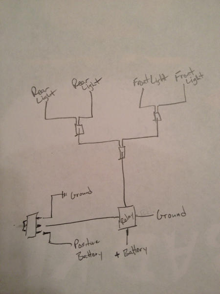

So it would look like this? I know my electrical drawing sucks.
Old Dec 30, 2012 | 07:50 PM
emt_micah's Avatar
Joined: Dec 2008
Posts: 268
From: Northwest, Indiana
Yep. That's it.
Old Dec 31, 2012 | 06:17 AM
matt1171's Avatar
Posts: 236
From: Conway, AR
Thanks for your help. I wired the relay in this morning and now everything is working great!
Old Dec 31, 2012 | 06:28 AM
emt_micah's Avatar
Joined: Dec 2008
Posts: 268
Awesome. Please post some pics of your install.

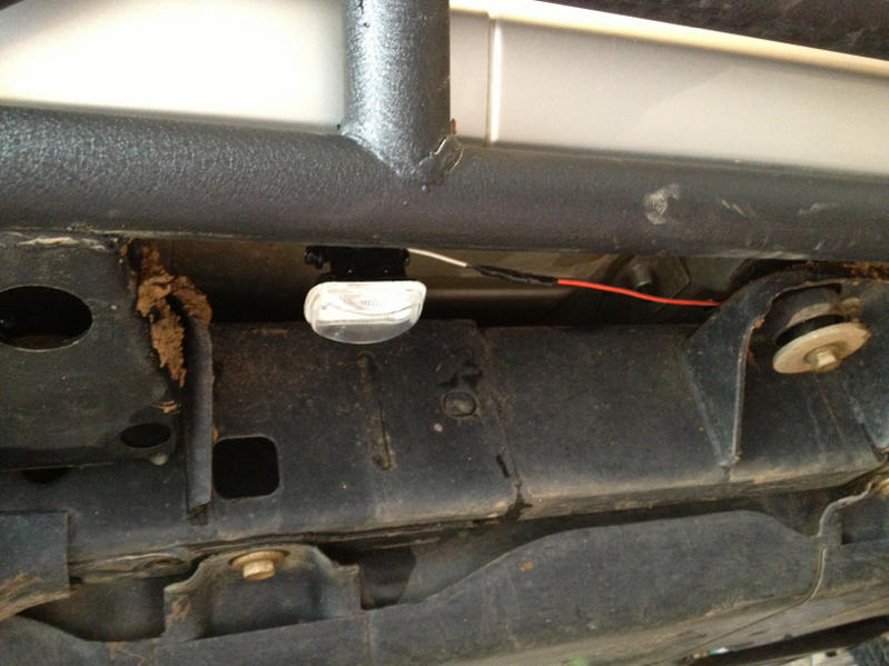

Ok guys. I'm afraid that it isn't as simple as that. What size wire are you using from the battery to the relay? From the relay to the lights? That is just for starters. What size fuse are you using. If all this information doesn't coordinate, then you have a fire risk.
Old Jan 1, 2013 | 03:12 PM
matt1171's Avatar
Posts: 236
From: Conway, AR
The wire from battery to relay is the big yellow (can't remember the gauge with a 30 amp fuse). The wire from relay to lights is red and heavier than the wire that came with the lights.

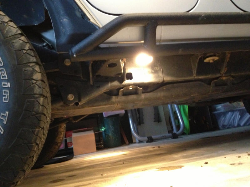

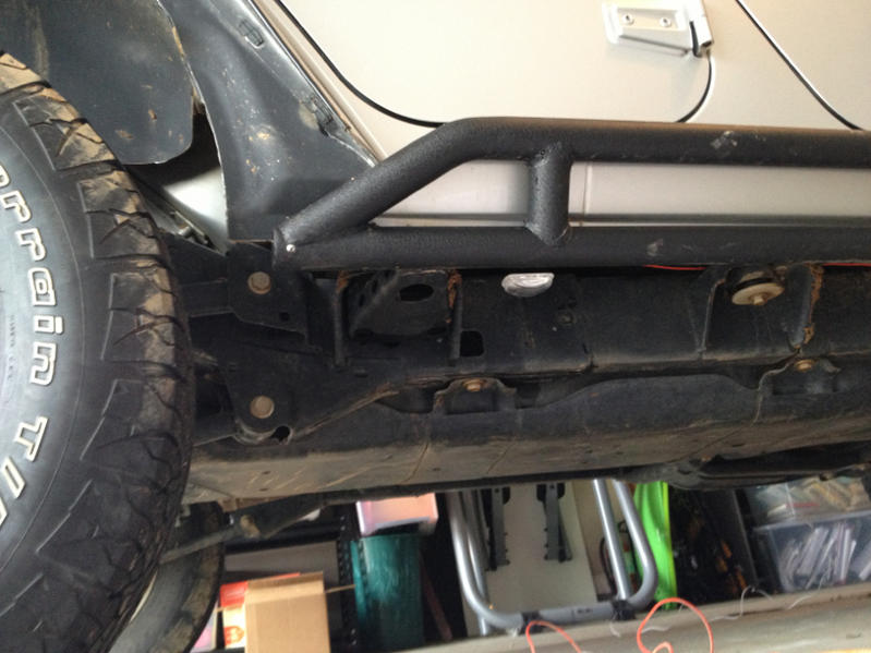

Here are some pics...
