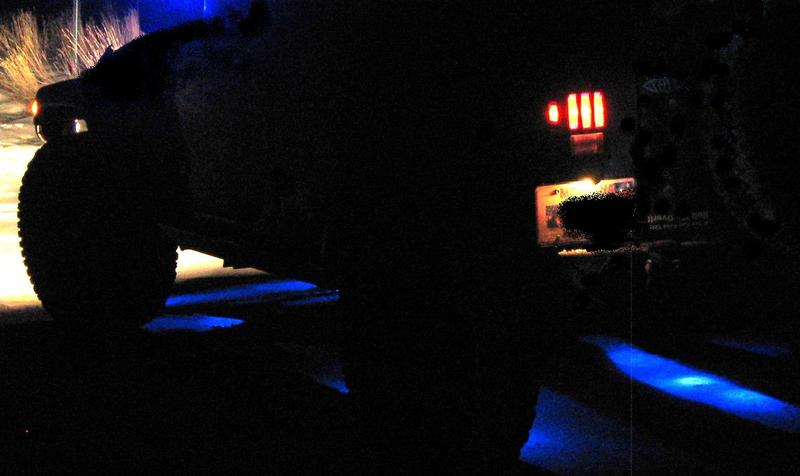

I bought some cheap led's too...
they came in packs of 4... each of the 4 "blocks" was 1 inch by 2 inch ...1/4 inch wide... the "blocks" have three lights... one aiming down one angeled forward and one back.
I ran the wires from the rear drivers side in a loom over to rear passenger... up into the gas tank skid... up into engine compartment.
They were glued to the frame in four locations... and they work pretty good!
Total cost for lights, switch, wire was under 25 dollars... two years no failures. Oh... I did coat the packs in silacone so no water would get in and gravel would be deflected without crackign the "blocks".

I went with blue... but White would have been briter!

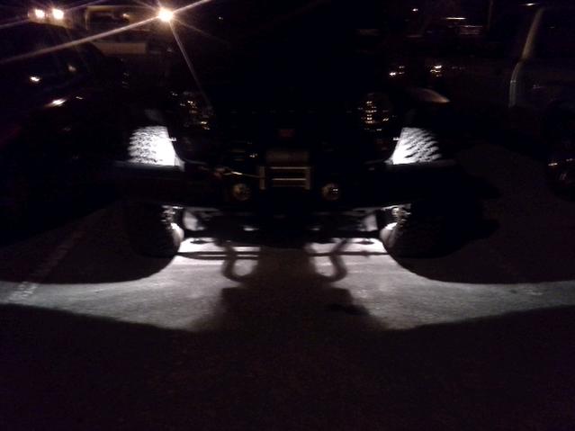

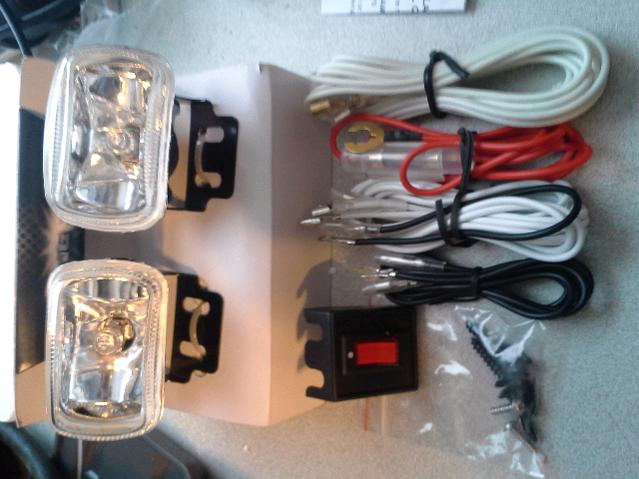

Dude for $18 you can't go wrong with the Walmart lights

Holy two year old thread Batman!
The advantage of the Walmart lights is that they are indeed cheap. Problem is they are halogen which heat up which when hit by cold water sometimes kills them plus they have a more pronounced footprint which makes it easier to destroy them on the rocks if they're not killed by vibrations first. Additionally, much more current draw on your system at night. Last disadvantage is that while they are good for those in the driver's seat, if you're being spotted by someone else at night it is going to blind your spotter due to the flood pattern that they have shining light everywhere. If they're almost $20 a pair, that's almost $80 for a set of eight of them and not too much cheaper than quality LED sets.
I exclusively sell and use myself the Vision-X Tantrum lights. The price point is right, the beam pattern won't blind your spotter at night, very little current draw, plug and play install, much lower profile, immune to being under water and impervious to vibration.
