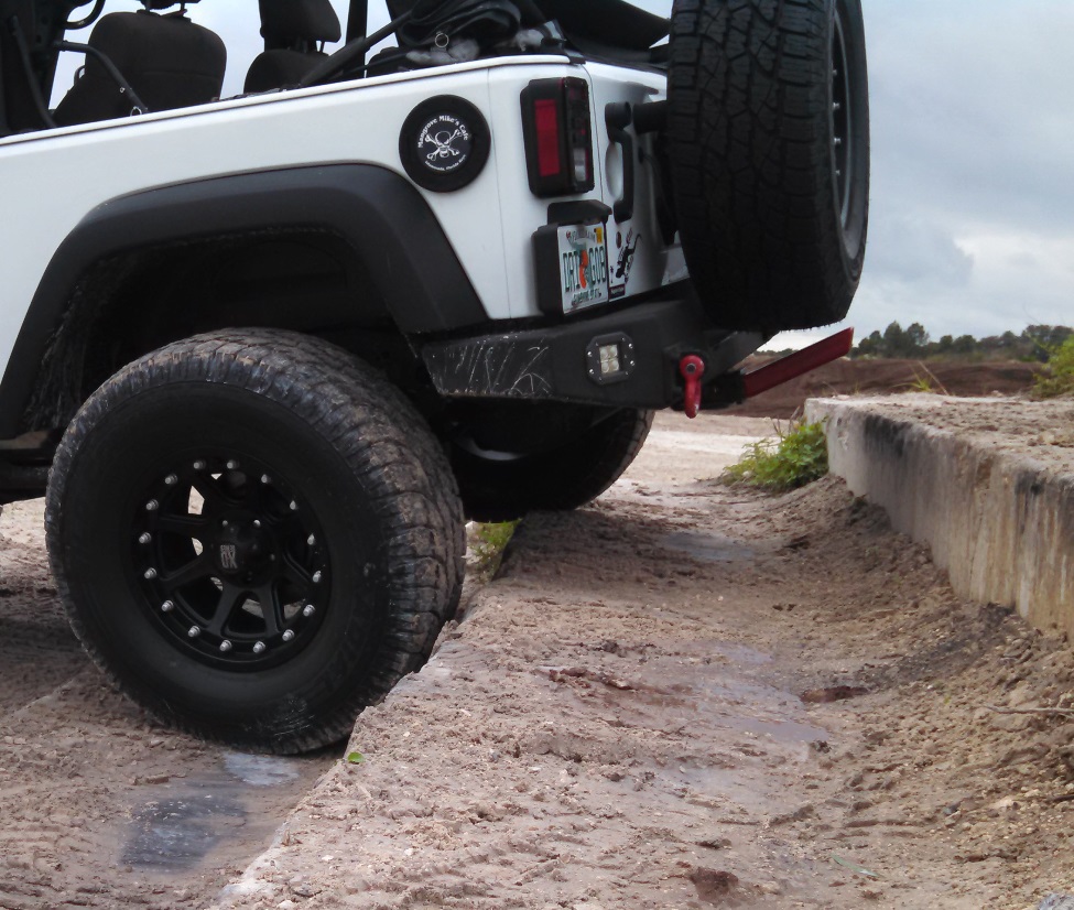

I have ran 2 led flush mount pods in my rear bumper for over 2 years now and have not had a single issue.
I tapped directly into the back up light wires. And yes, they come on every time I'm in reverse and I like it.
If I was going to use a higher amp/watts draw light like the halogens, I would run a separate power,relay, and switch like the others have posted.
