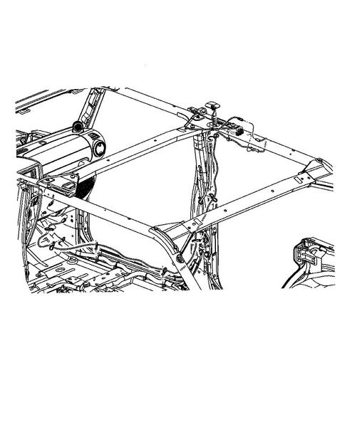

Where is the sat ant on JKUs that have the sat radio installed from the factory?

The factory mounts it on the top of the B Pillar.

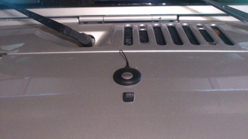

On the hood, for 2 yrs now, ran the cable through the firewall, drivers side through one of the grommets. Missing that stick on hold down for the cable now that I look at the picture, but I have a spare somewhere I'll dig up..

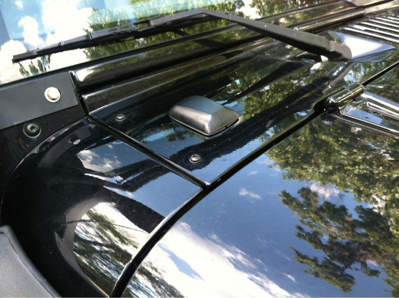

Mine is mounted on the cowl. It lost reception after I put on the gobi rack so I moved it. Not too hard.

How did you go thru firewall? I like the position if this.
