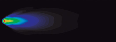

As far as spot vs flood, it's just a matter of where you want the light to go. As an example:
Spot

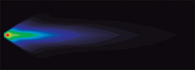

Flood
Both Wurton and Rigid make quality lights. The brightest of the bright out there are Vision-X Evo and Soltice series, but $$$
