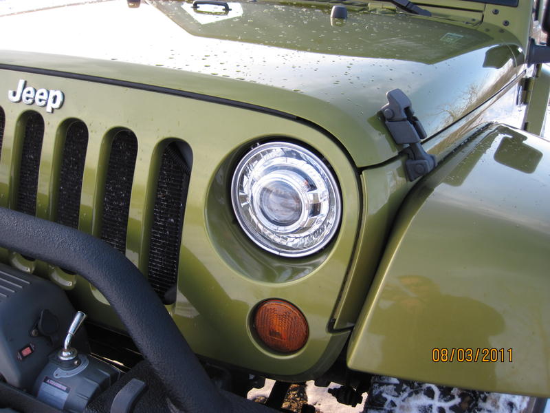

I just finished my first projector retrofit a couple days ago using the Morimoto Mini H1's and they seem to work darn well! Excellent cut-off with a nice flicker at the steps and the highs are phenomenal. There's a huge difference between real bi-xenons and the crappy ass P-N-P kits, all the light is focused where you need it and on coming traffic no longer gets pissed off.

any cut-off shots? how difficult was the retro? did the Morimoto minis fit easily?
Not yet, I can snap some this evening after dark.
The retro wasn't that difficult, but not quite as easy as I hoped it would be. I went with the mini's as the rear of the housing is threaded and is supposed to be an easy mount in the H4 and 9007 headlamps and I was hoping the H13's would be similar, that however wasn't the case... The 7" round Jeep headlamp is about an inch too shallow to completely house the projector itself, so I did have to machine out a decent amount on the backside of the factory reflector to get it to fit.
This being my first retro, I bought a second set of factory headlamps from a user here in the event I totally screwed one up, I wouldn't be out of a headlamp. Literally the biggesst issue was separating the lens from the reflector, the big key here is NOT to rush to pop it off, but instead slowly spin and pry on the lip. This was still difficult after heating the headlights in the oven for about 20 minutes at 250 degrees, that Mopar glue is apparently some good stuff! The reflector housing itself seems brittle and will crack and chip easily if forced too much, so definitely take your time working your way around.
They've only been in there for 3 days or so, but I couldn't be happier, they seem to perform outstandingly well and live up to the hype. There's a forum section over at the retrofit source dot com that had some good reading and aided in the retrofit, it's worth a skim through.
