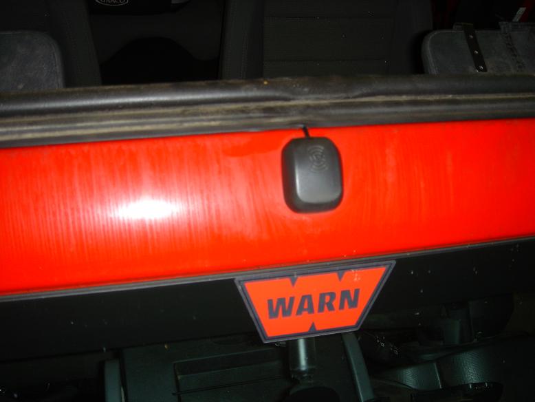

I put mine here. top center of windshield. Doesn't interfere with either top, and great reception.

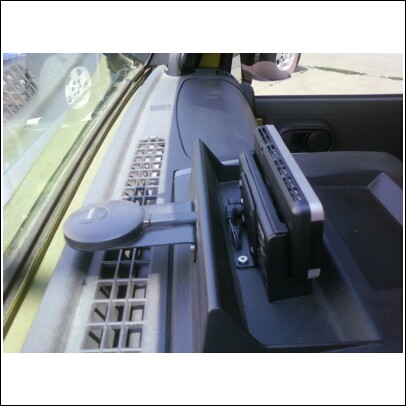

I installed my Sportster 4 on the Daystar panel and made a bracket to hold the antenna at the base of the winshield inside the Jeep.
Name:	Jeep Sat install.jpg
