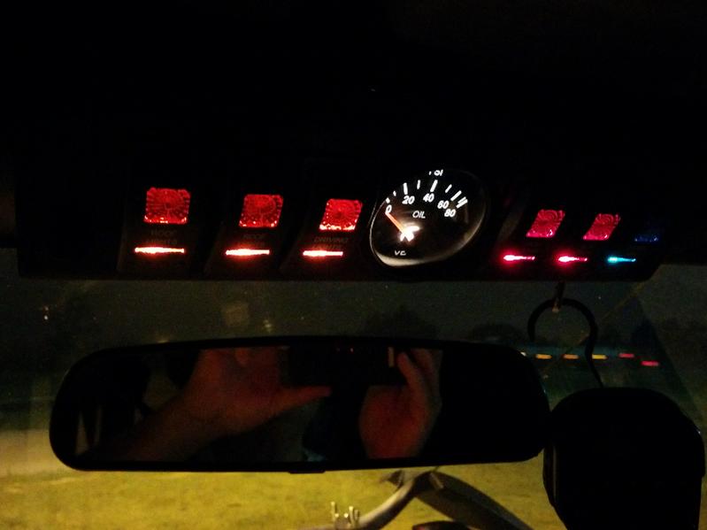

Yes, they will sell you a kit with a button to turn on the "dash" lights. But mine don't have a separate wire. It is wired into other sPOD power--no extra install labor required. I plan to someday wire into dash lights, though. Right now, full bright lights by rear view mirror are a bit annoying at night.
Edit: Oh, while you're in there wiring things, consider adding the control with the gauge opening. I use mine for oil pressure. Bit short of an opening for some gauges, though, so research carefully if you opt to do.

And the problem with the sepetate switch is you'll forget to punch it off, thus leaving the dash lights on while you go to eat breakfast, as I just did!
