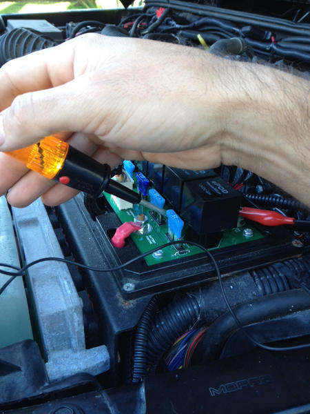

Fuse 2 is good.

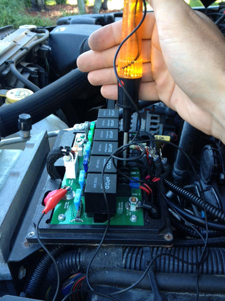

Diode 2 is good. I've swapped relays between working circuits and this circuit to make sure it wasn't a bad relay. Relay is good.

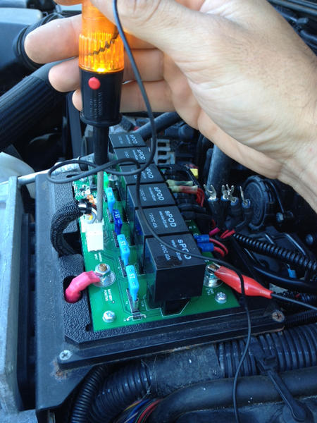

No power out to SW2 side. Either a problem with the bus/pos connection, or could be the relay harness on the board.

Ground side of 2 is good.
