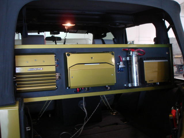

x3 on nothing else needed. I'm 3 years in with my set up w/ no problems.
To my knowledge, w/out the can-bus whatever relay BS thingy the only thing you lose is your radio face will not dim with the interior lights. And who the hell cares.
This whole setup is ran off an Alpine headunit with no bs interface, just a straight up wiring harness like putting it in a 91 civic.

Nice setup

Nice setup
Thanks man. Created from Crutchfield and craigslist and some paint haha
