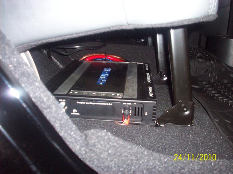

Not trying to take over thread, but here is an idea for the amp. Under the back passenger side seat
