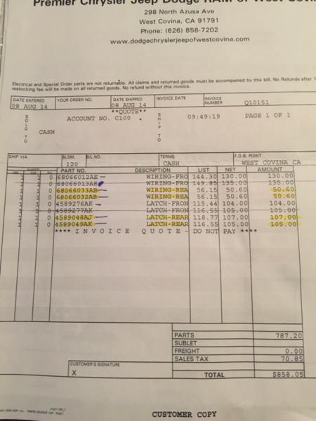

Here's the parts list for my 2012 JKU!!!

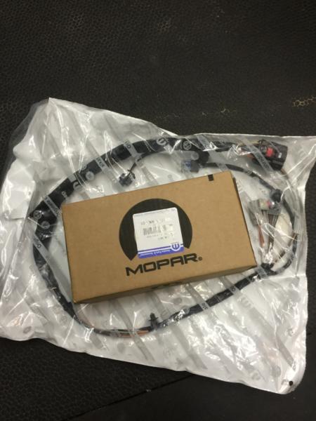

Here's the wiring harness and latch in box for front passenger door!!!

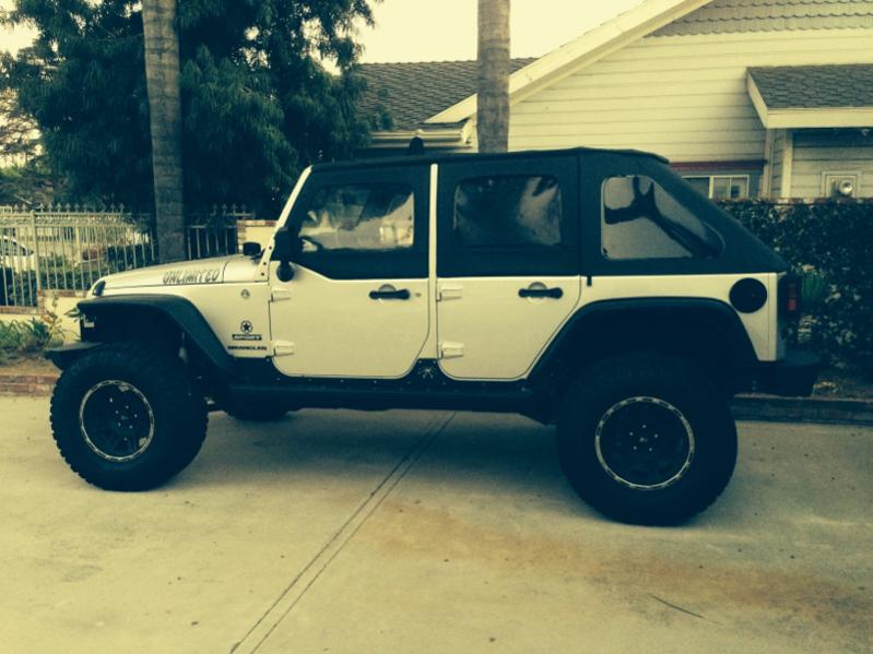

Here's mine!
