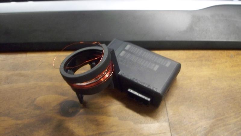

Well I was outta town for a few days and came back with a clear head and just started looking at all electrical connections, I decided to use the OBDII scanner and see if there was any codes (even tho I had no CEL), as I put my head down in front of the seat to plug it in I noticed a large crack in the plastic on the underside of the steering column directly under the ignition cylinder. It looks as someone has gotten in a slammed their knee into the column, so I took the plastic off from around the steering column and found this (hope the picture shows up).
ID:	472060 As you can see the plastic is busted and the wire is exposed.
This piece goes on over the ignition cylinder and is what "reads" the key, so I went to the dealer and purchased the part $120 had them program it $180 and it's all back to normal.
Just wanted to let everyone know what it was.
