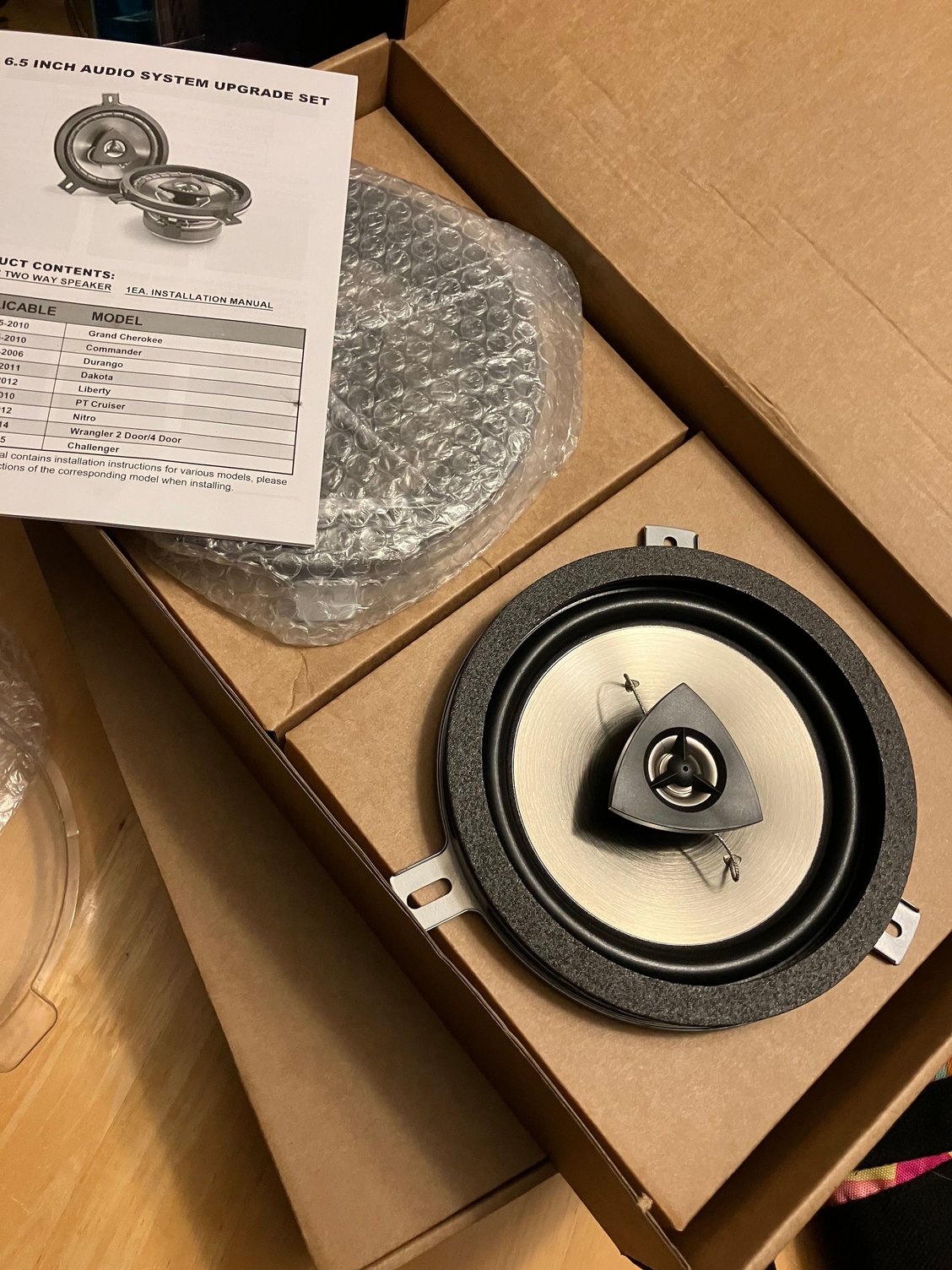

The 4 stock 6.5” speakers I swapped with the Mopar/Kicker 77KICK10’s.
(75w RMS, 4ohm)
These weren’t too bad to install. The soundbar locations were simple. The passenger side took a bit of work but still simple. The driver’s side was slightly more involved but also wasn’t too bad. The soundbar was stuffed with polyfill as were each front speaker pod.

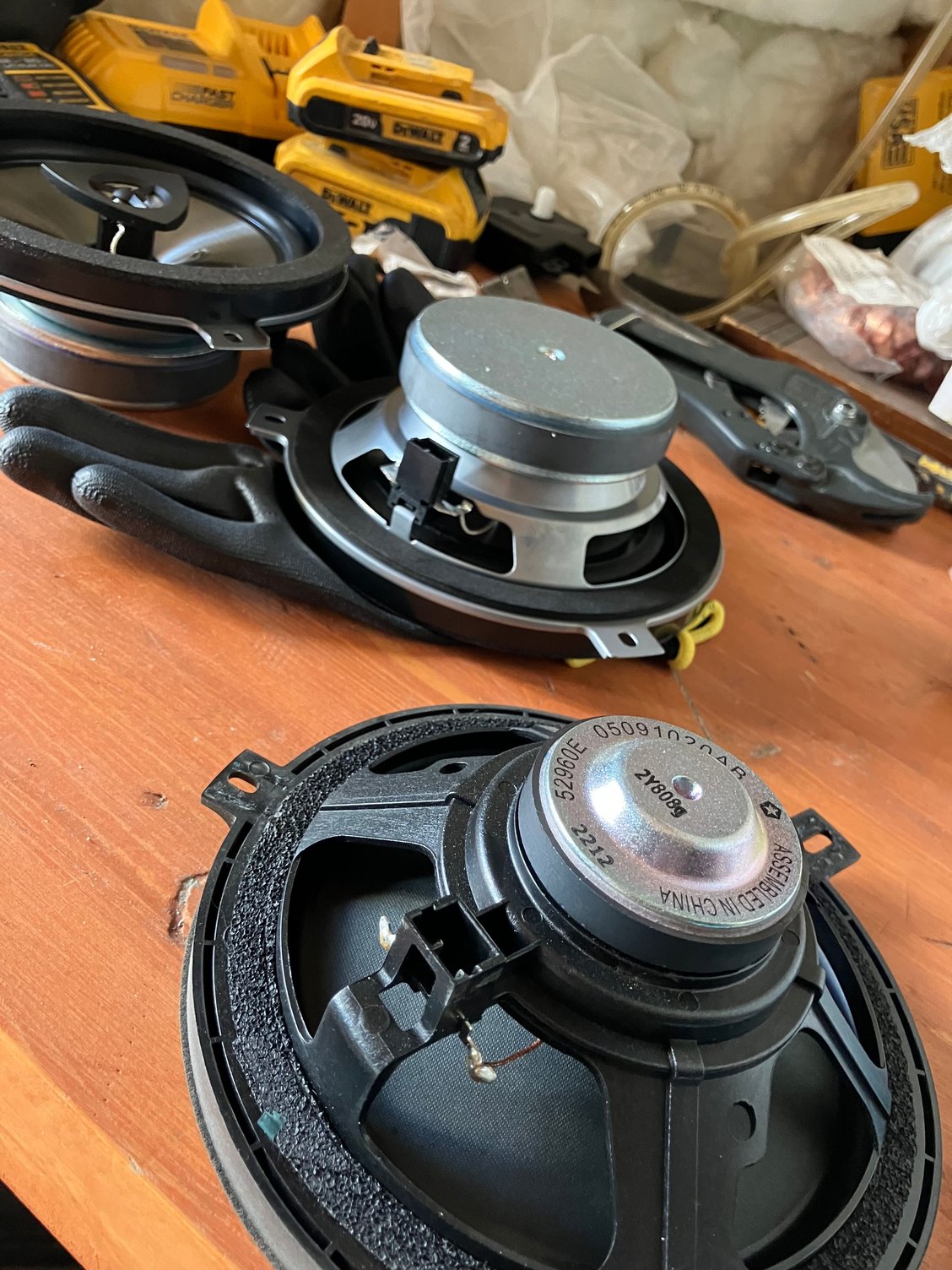

Stock speaker in foreground, 77KICK10s in background.  Huge magnet difference!

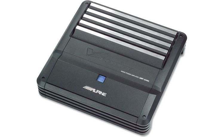

An Alpine mono block was installed under the driver seat to run a subwoofer.(Alpine MRP-M450, 400w RMS @ 2ohm)

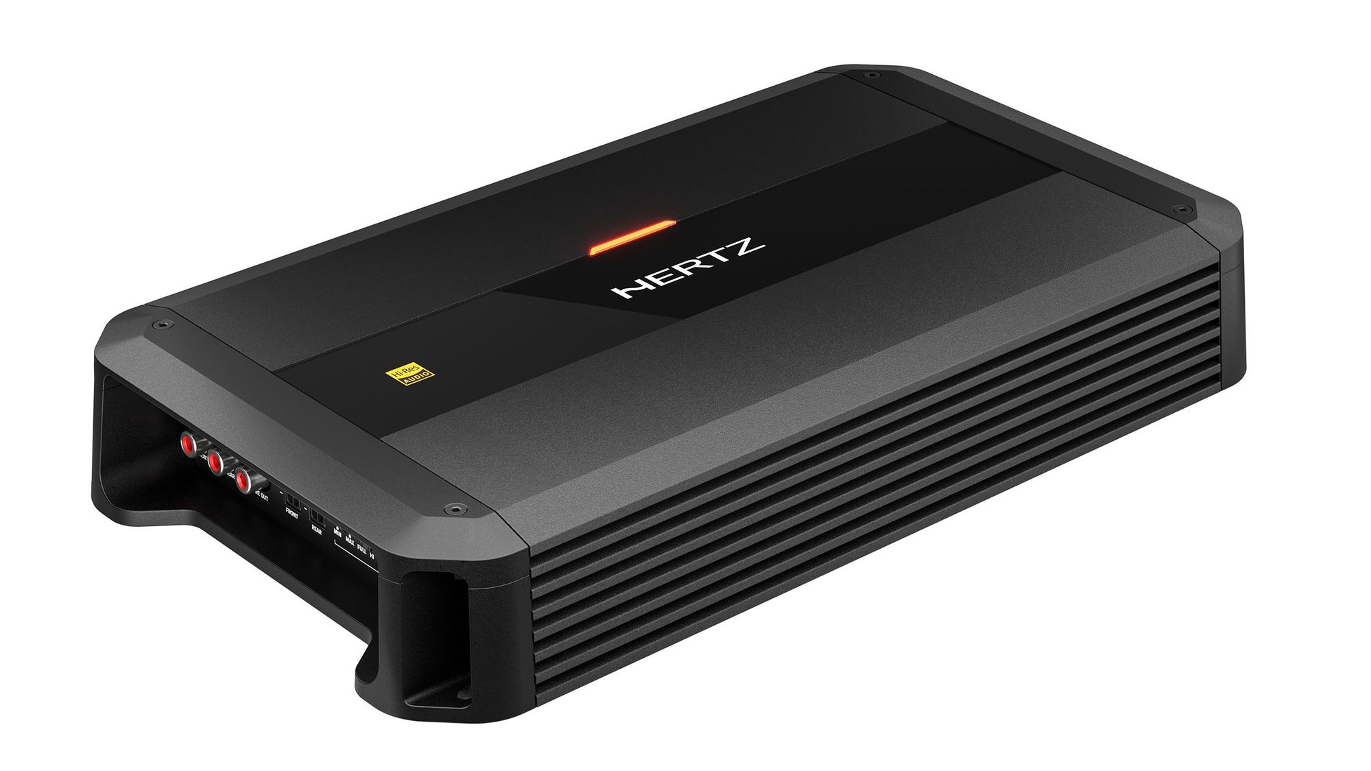

A Hertz amp was installed under the passenger seat to power the speakers.
( Hertz DP 4.400, 75w RMS x 4 @ 4ohm)

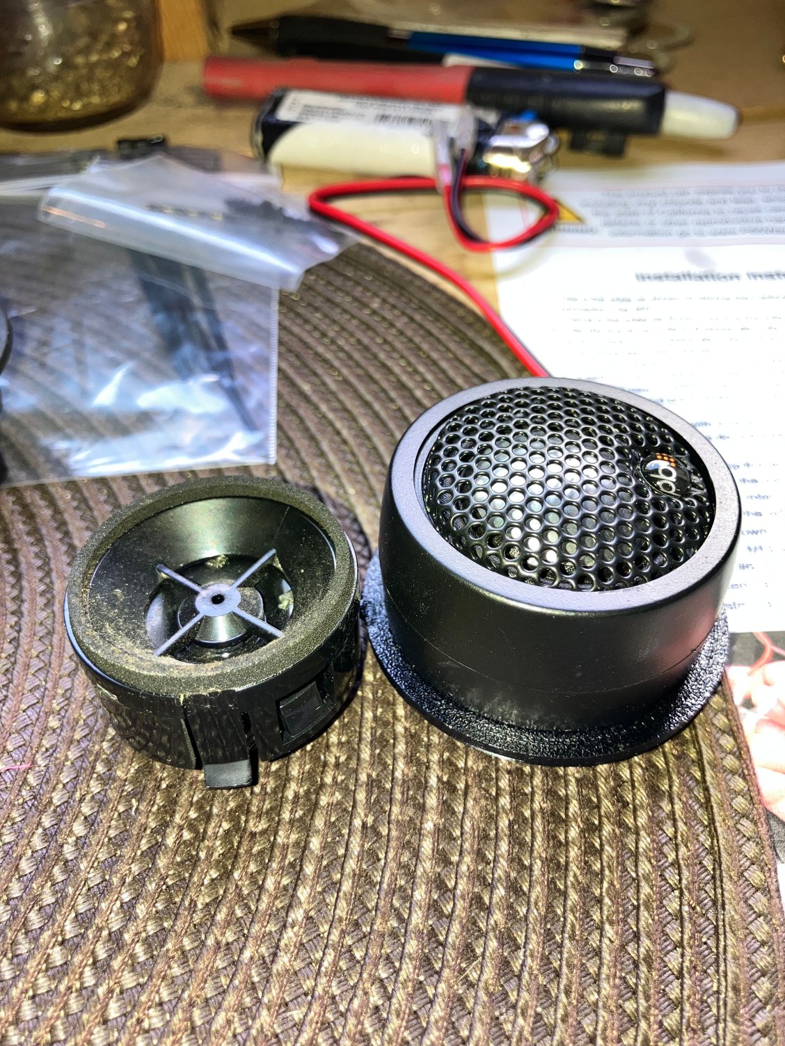

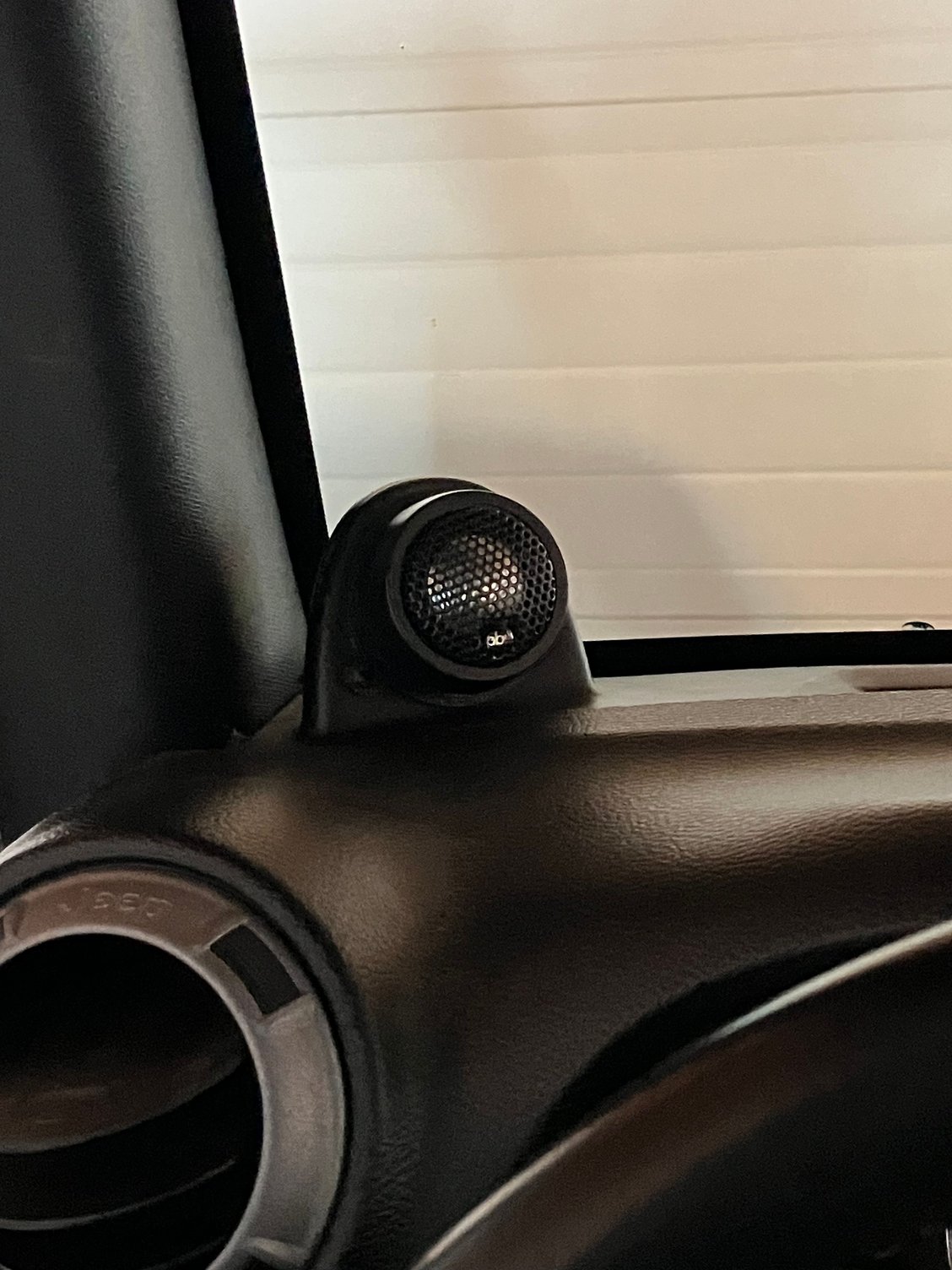

I installed the Quadratec SuperTweeters in the dash tombstone mounts.
(JK-TWEET11s, 50w RMS)
These were a fast swap. Jist removed the old ones, added the new ones and hooked them up with the included crossovers inside the side dash panel.
Stock Tweeter on the left!

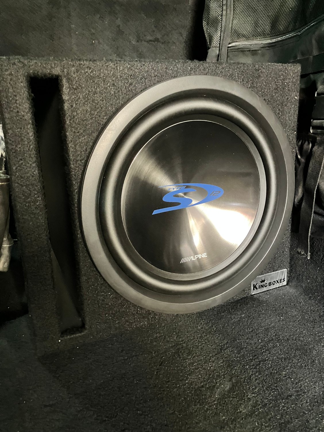

I had a 12” Alpine Type S that I mounted in a ported box in the trunk.
(12” Alpine Type S SWS1242D,300w RMS, 2 x 4ohm coils)
