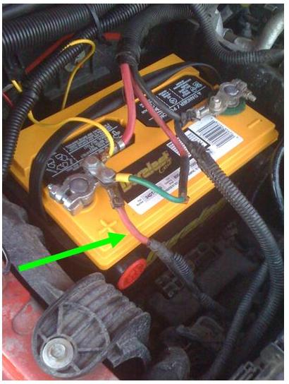

Default More Info
Thanks for the responses. I think I we are narrowing down to the root cause of my woes.
The battery light came on again this morning on the way to work. I stopped and tested the voltage at the terminals. 14.45v
Check the attached picture.
Name:	Battery Cables.JPG
The cable indicated was wicked hot. Too hot to touch and some of the insulation looks like it has melted!
What could be causing this? The PCM? I have scheduled an appointment at the dealer to get the 18-036-06 TSB performed along with some recall work. What should I tell the service tech? I don't want my flame red to flame up!

Tell the service to check the alternator regulator. Also tell him/her about your high voltage readings. Also let them know that whatever is causing the high voltage also damaged that wire. You want that wire replaced.
The wire is hot because it is carrying more current than it is supposed to. Any time you feel a warm or hot wire something is wrong.

Yes..15.2 is to high...it's overcharging..definetly get that thing in to be serviced. If a wire that size is getting that hot, some serious amps are going thru it. be VERY VERY careful when driving that thing and go straight to the dealer! Maybe that is the cause of some of these jeep fires that we are reading about.
It's at the dealer. Wating to hear the prognosis.
I have thought the same thing about the fires after burning my hand on that wire. I wonder if it happens more often than people realize? Maybe I have just been lucky?
