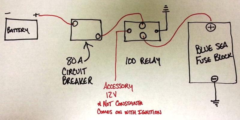

Not exactly sure how you have the relays wired up or what powers up the relay coil to pull in the relay, but if you are using power from the CANBUS system the relay will chatter due to the voltage pulsing instead of being constant.
You can verifiy this using an analog volt ohm meter and measure the actuating voltage for the relay.... The needle will fluctuate indicating modulating voltage instead of indicating constant 12VDC.
You would need to install a capacitor inline for the positive activation source to ensure the relay stays energized.

I am trying to understand your setup fully. I read and reread it and believe you are getting a delay in only ALL of the accessories that are connected to the 100 amp disconnect, relay or whatever it is. IF that is true you can try 2 things. 1. Replace it. Or 2. Jump it out with a heavy gauge wire to see if the delay is still happening. One question, once it finally works and you turn the Jeep off, will it delay again when you re-start? Can you better describe the 100 amp thing?

Here's pics of my wiring diagram and the items I used...
I am pulling the 12V from an open fuse slot in the factory fuse block with a Add-a-circuit so I'm not sure that is what you mean by the canbus system. As far as turning the jeep off and then back on goes, there is no delay.

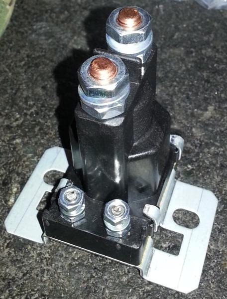

There are 2 kinds of high current solenoids/relays available. One is an intermittent on and the others are continuous on. You might be getting coil burnout on an intermittent one when you are looking for continuous on rating and this means it would eventually just not work. This is to do with the relay coil not the ability for the relay to conduct a high current draw through it. Put a voltmeter on it and see if there is a delay and note when it actually comes on as it may take the higher voltage from the battery recovery charge after start to actually pull it in due to the coil failing. Failing this it could just be a loose connection.
Old Jan 4, 2022 | 09:40 AM
Faalin's Avatar
Joined: Aug 2020
Posts: 65
Likes: 11
From: South Bend, IN
My thoughts exactly, you ether have a intermittent solenoid or check the ground from the solenoid to the body. My first thought is you have the wrong solenoid, something like this is what you would need. https://www.amazon.com/Rareelectrica...s%2C106&sr=8-8
