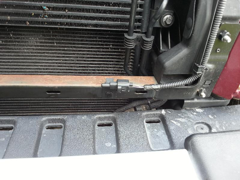

Anyone know what this sensor is behind the grill on a 2012 jku? Took my grill off to plastidip and paint that rusted bar so was Just wondering what this was.

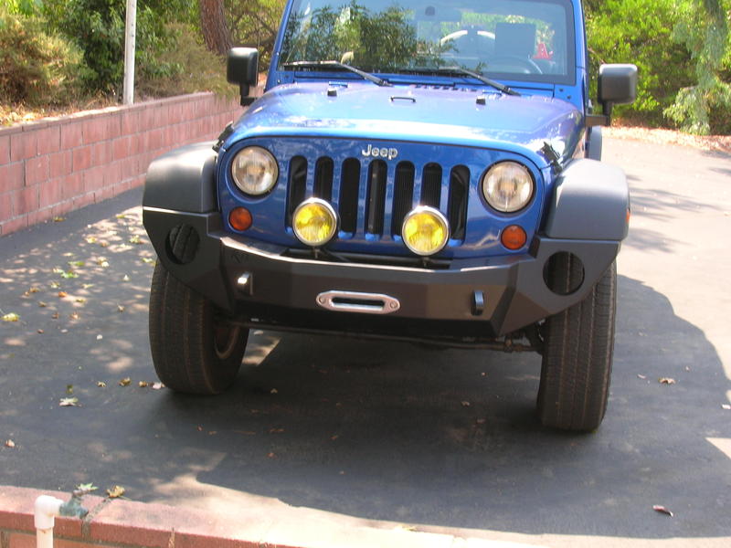

That is the outside temperature , the lights on my bumper blocked air flow made it read 10 deg. hi , had to move it up to resolve the problem.
