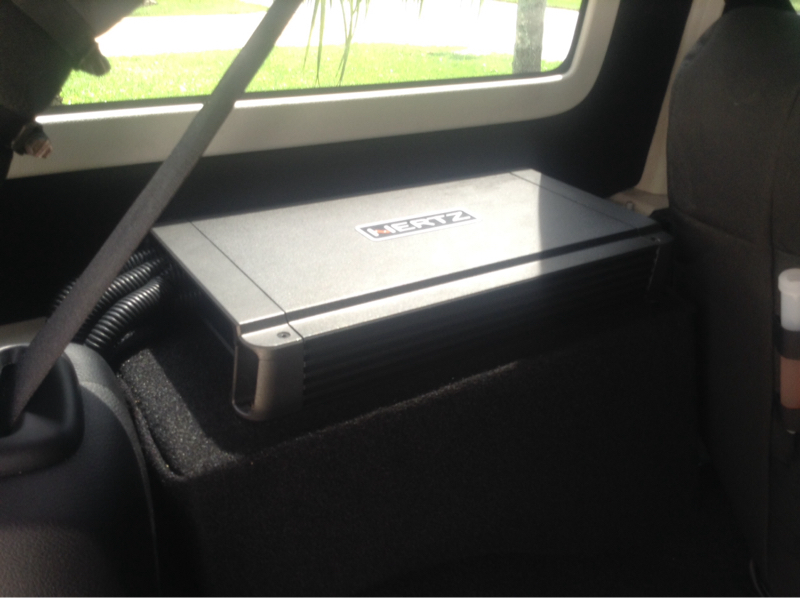

Custom rack, installed over driver side wheel well.
