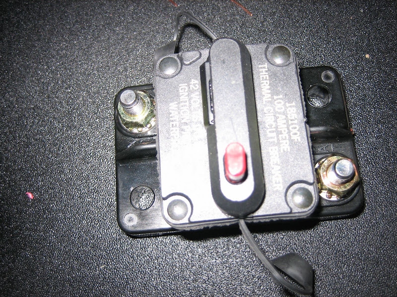

This is my current set up...I used to have a similar box as you before I upgraded and I had it mounted under the hood (last pic)
100amp circuit breaker
ALL DONE!!
OLD SET UP BETWEEN THE BATTERY AND STOCK FUSE BOX
ALL DONE!!
what brand name is that set up ? where did you get it at ? thanks
