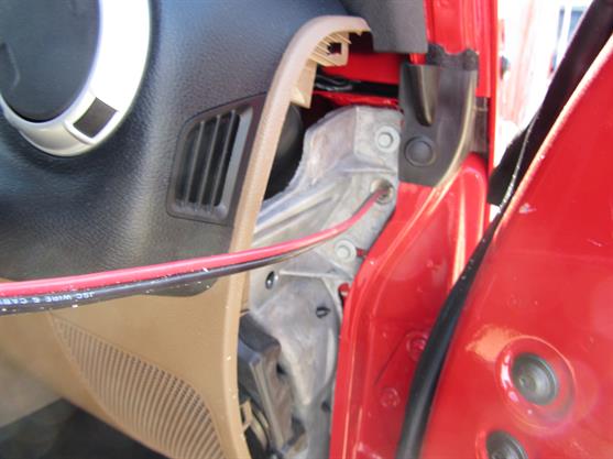

Passenger side with plastic piece removed:

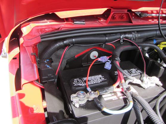

Wires coming off battery and into the passenger compartment (kind of have to look closely where the wires run thru a fold in the metal).
