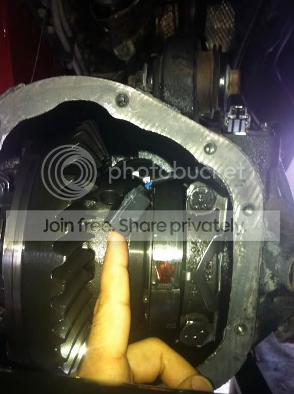

Your locker is DEFINITELY engaged. I had the total opposite problem with mine. The Front Locker would not engage and actual failed anti-rotation clip broke...here's a pic
Probably installing ARB's or OX Lockers next week...Still not sure what will work best with my Rubi
it could be the locker, i see what you are talking about now, i just am not sure because it is mainly when i am slowing down and the esp light comes on and automatically brakes...could it be that the locker isnt FULLY unlocked?
