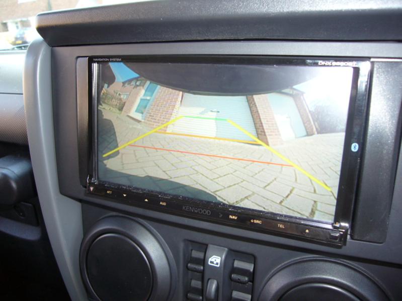

Not sure about that actual model but I have the DNX9260 and it works fine, just make sure you get the PAX harness as I had Cambus issues with a cheaper harness.

It will fit just fine and will not stick out at all if installed correctly. There are mounting inserts available that make it look almost factory. If you are running the infinity system you will be connecting the low level outputs of the Kenwood so your power output will stay the same. I just replaced the rest of my infinity system and have a can bus interface available if you are interested as I no longer need it.
