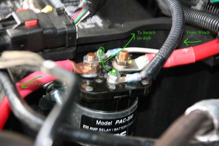

I used a battery isolator with a dash mounted switch. Just hit the switch to send power to the winch. It also has a built in relay that will automatically cut power to your winch if your battery drops below 200 amps.

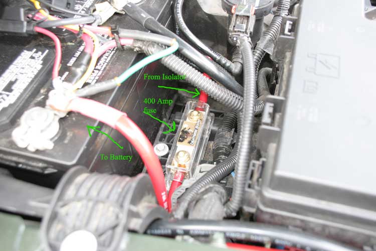

Cleared it with the tech guy at super winch, He said it should work fine. The max amperage spike of the Superwinch Epi9.0 is 400 amps. the draw under max load is 350 amps. The relay cuts power to the winch only if your battery output drops below 200 amps. allowing you to restart the vehicle if you are forced to winch without the engine running. the relay itself will carry over 600 amps. I also have a 400 amp fuse in line between the relay and the battery in the event of a dead short. I know it seems like overkill but I've read horror stories about guys burning up their rigs due to a dead short. I've done a couple of test pulls and it seems to work fine. I figure, worst case scenario, if the set up fails I can always jump straight to the battery to get it going again. I should have mentioned I wasn't using a Warn, it might be a different story drawing higher amperages.

ptcomp you mention a dash mounted push switch. can you give me some insite, so I know what I/m looking for. i read a post a while back about the solenoid locking or freezing up causing a fire. I want to avoide this as my solenoid is mounted next to my battery.
The isolator I used has two terminals that allow you to run wires to a switch letting you turn it on and off.
Here are some pics I hope they help.

Where did you buy that 400A fuse?
