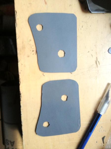

-lay the bracket flat on the liner and trace with a sharpie
-cut about 1/8" inside your line (except for the two holes)
-VOILLA! Custom buffers.
It takes all of ten minutes.
