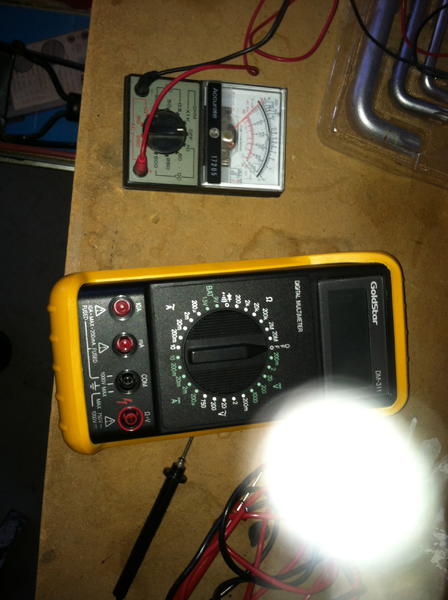

This doesn't give you an immediate answer, but you might consider investing a few dollars in a VOM. You don't need the fancy shmancy one on the bottom, but the one on top will do the trick for just a few bucks. Once you have it hooked to power, you can isolate exactly where you're problem is. No more guessing.
<img src="https://www.jk-forum.com/forums/attachment.php?attachmentid=492234"/>
Yeah I hear ya. Ill probably end up getting one
