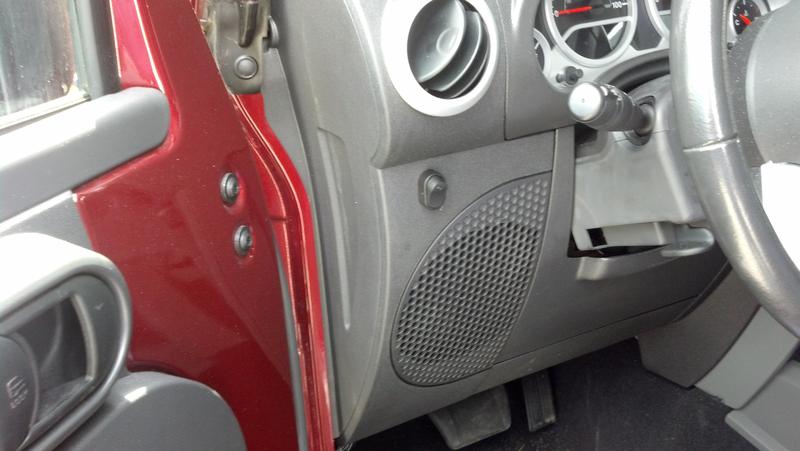

I have a 20012 and you have two factory options, on each side of your dash you have a vertical plastic panel that pops off. Each panel faces the door. Pop off one of the panels, which ever one is closer to the switch you install. You will see a rubber grommet on either side the penetrates the firewall. Very easy to do!

Yes! Foam filled hole is what I used. Pop panel off either side of dash and you will see.
It doesn't actually go into the engine compartment but along side it still under the hood. That's how I wired my KC driving light relay switch.
