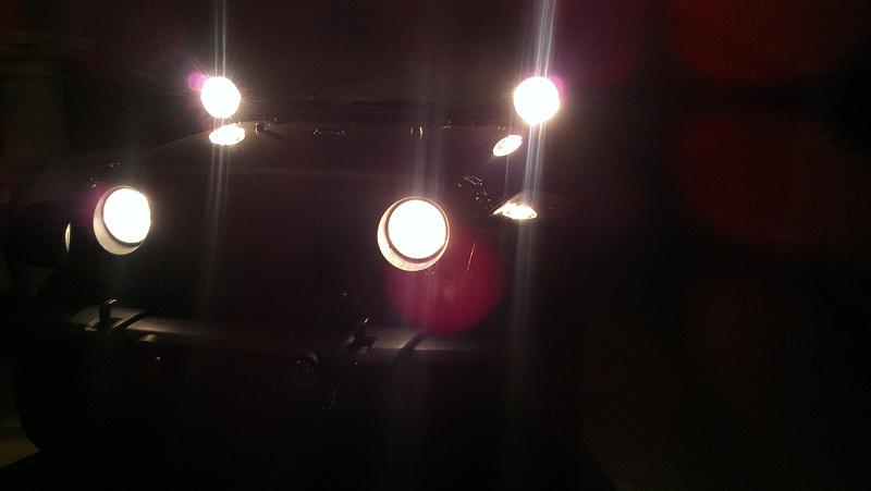

Been meaning to post and never got around to it. Got them fixed the next morning with that blade fuse holder. I appreciate it!
