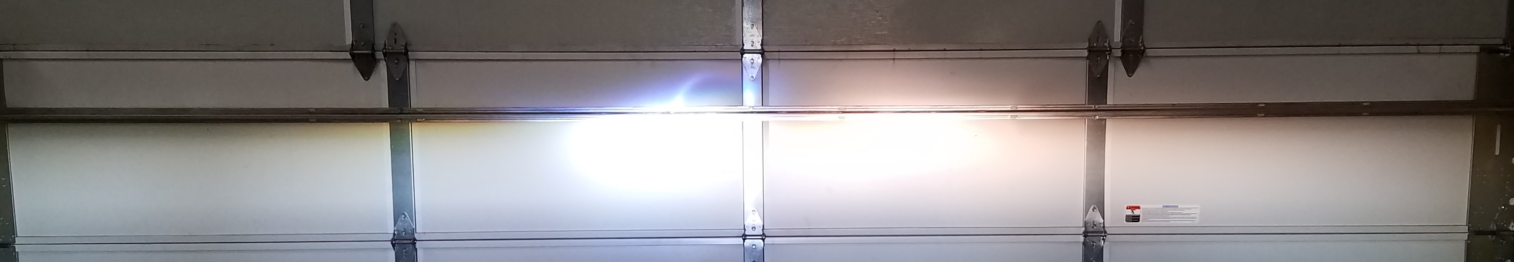

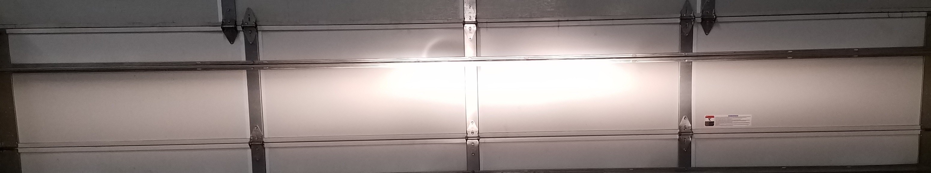

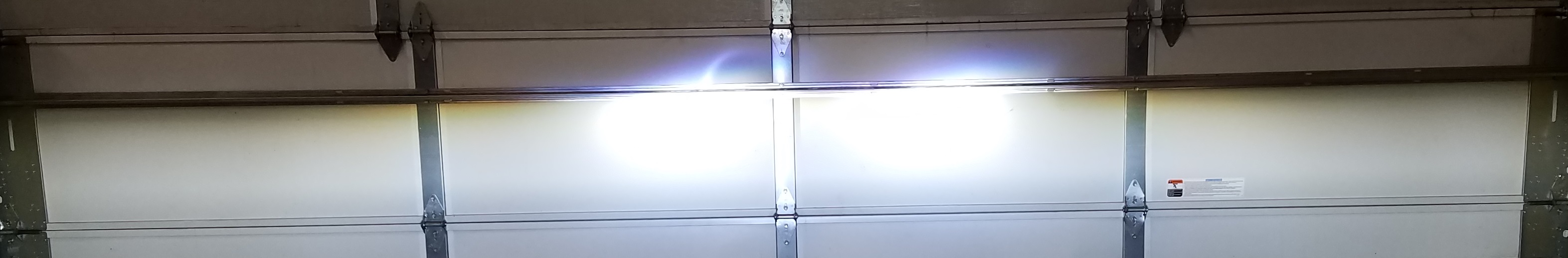

Finally got all the Black Friday deals installed. I got impatient waiting for a headlight to go out and just replaced with a pair of JW Speaker 8700 Evo J2. They were only $50 more for the pair on sale compared to the J's, and they have the ability to leave low and high beams on simultaneously.
Before:
One Changed:
Both Changed:
One neat feature of these is that when you "flash" the high beams (pull lever in, instead of pushing it out) it actually leaves the fogs on as well as the low beams, which is handy when approaching an obstacle at night. This is such a step up that I no longer see a need for forward-facing auxiliary lighting, although over time I will add both underside rock lights and additional reverse lighting when I replace the rear bumper. On-road they surpassed expectations. I don't worry about deer sneaking out of peripheral vision, I can see road markings even in inclement weather, and vision is greatly improved overall.
I do wish I had taken this time to make horizontal adjustments by notching the screw with a rotary tool (or replacing the screw.) Now that the winch plate is blocking the grill in place, I don't know if it is feasible without removing everything. I haven't taken measurements, but they seem a little cocked towards the driver side when I am driving. Not so far that it's a hazard, but it's distracting at first.

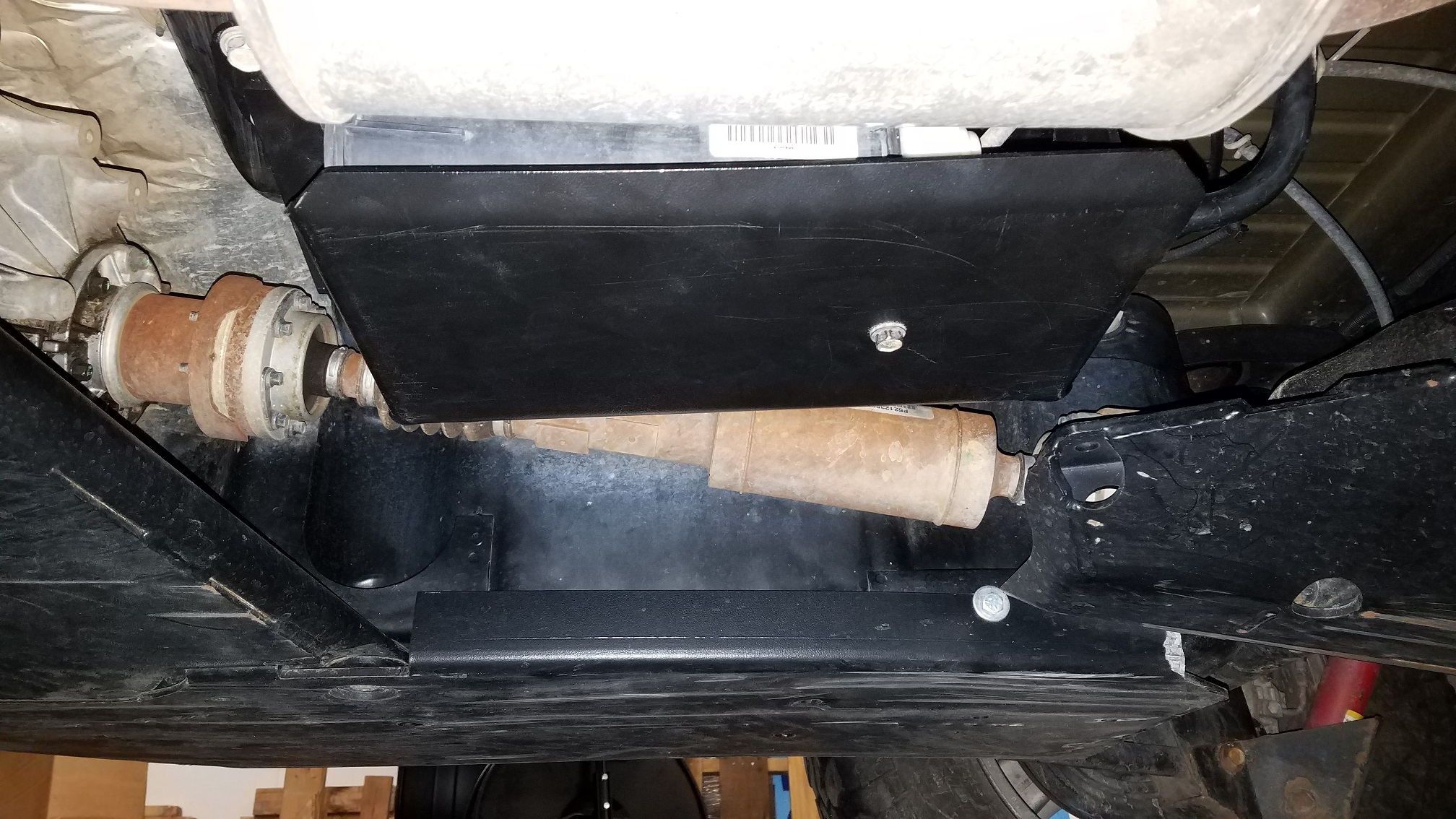

I also finished the skid system with a Rock Hard evap skidplate:

One Changed:
Both Changed:
