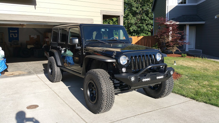

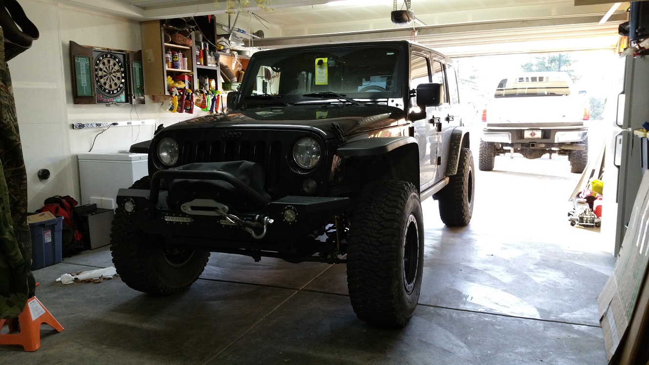

As she sits now:

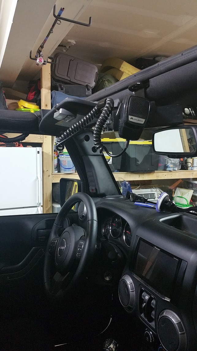

Got my CB mounted & light switch panel put in last night. Have to pickup some more wiring & a grounding strap to finish the CB install and to hookup some more lights.

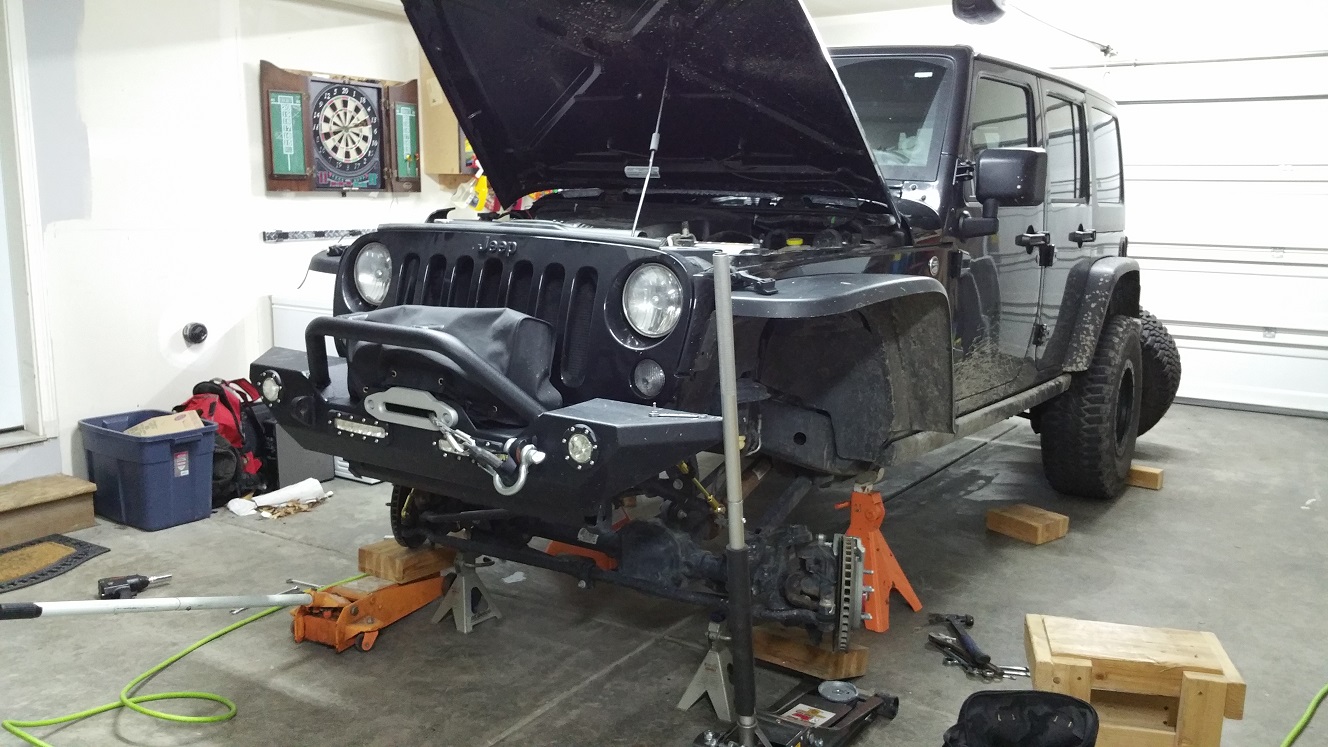

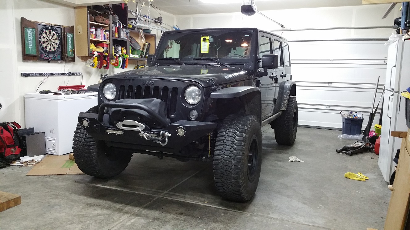

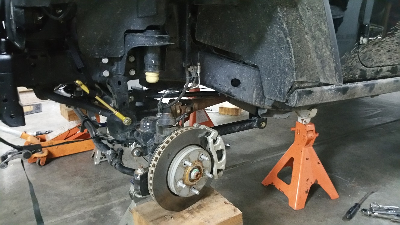

Got the lift and shocks finally. So I went ahead and put it all together over the weekend. Started Friday after a morning of hunting...which was very slow. Wish the snows had come in closer, blue bird day...oh well...better luck next time. Bentley(the dog) had a great time getting some training in.
Back to the house, cleaned out the gear and then got to the lift. We managed to get the front end mostly tore apart Saturday evening before dinner. After dinner we really didnt feel like working anymore so we called it. Sunday we started after breakfast, around 10am, then finished up around 3:30pm.
Installed:
Rancho control arm drop brackets
RK 2.5" springs
Re-used the 3/4" spacer for the rear for some additional lift
Rancho RS9000 shocks for a 4" lift
Metalcloak front & rear bumpstops
RK rear track bar bracket
This week I'll be taking it in for an alignment and to get the track bar relocation bracket welded on. Also ordering up some extended steel braided brake lines. Im also looking into extending my breather tubes and replacing the diff covers.
