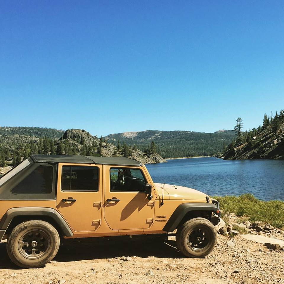

So here it is. I bought a Dune 2014 JKU sport hardtop back in January and have done a few minor things to it. First thing I did was get some mickey thompson classic 3's in 17x9. In spring I ordered the Offroad-heroes (california tops) fastback soft top. Since I had a soft top on in the summer I wanted to make sure and protect the seats when the top came off, so I ordered trek-armors front and back in all back. And finally I put a rugged ridge modular bumper on the front with the double x striker bar. Here's a little shot of my jeep so far out at lake Fordyce. And that's it! So far...
Attachment 627687

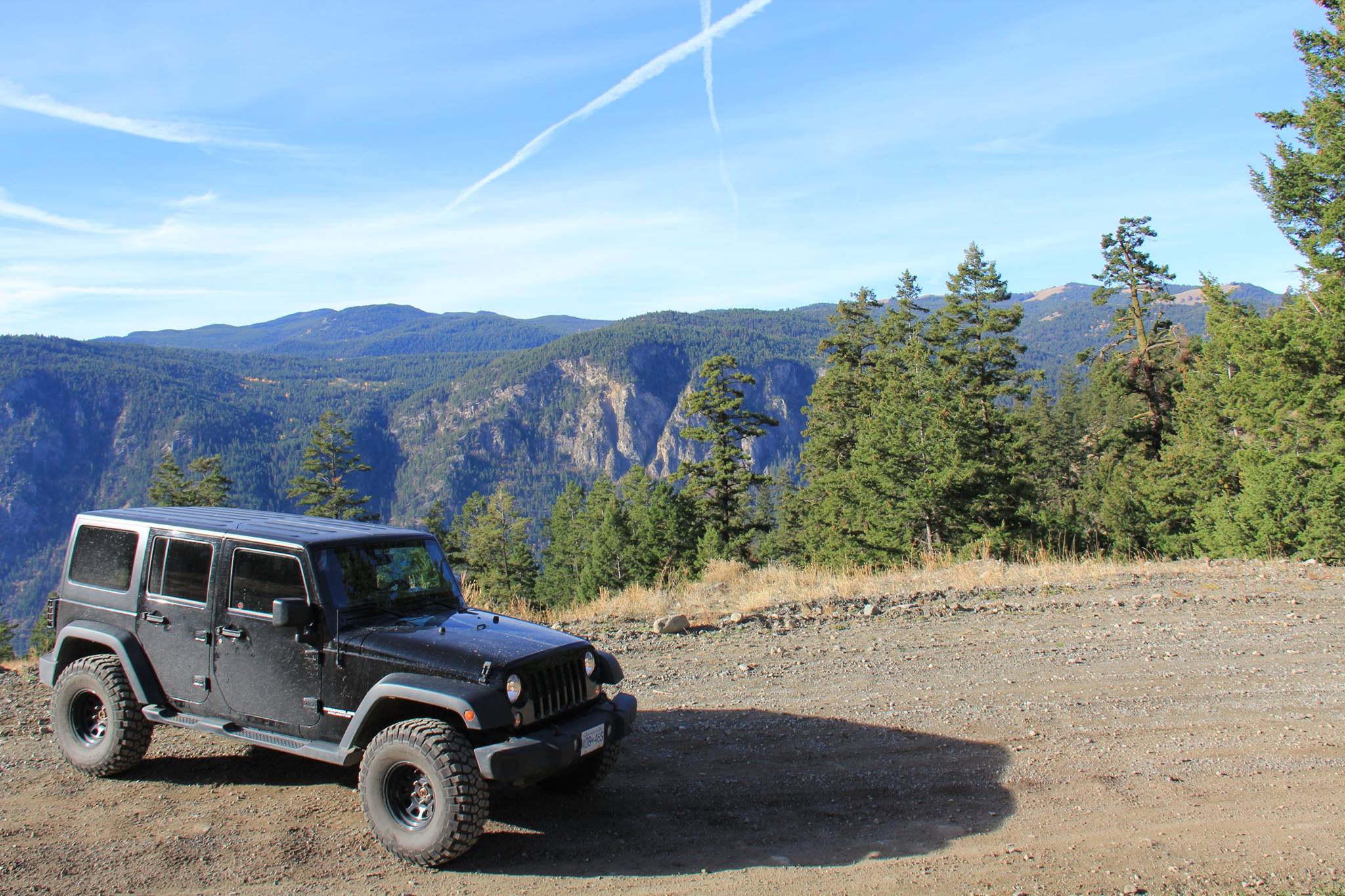

If for whatever reason you decide on 35's over 37's, 4.56 gears are good. They are not needed right away, if you can't afford them for budget reasons. Running a Superchips will help gain you some power back.
Here is a pic of my JK with 2.5" (Teraflex) lift on 35's (BFG KM2) tires for reference.
Hope this helps, looking forward to seeing your decision.
