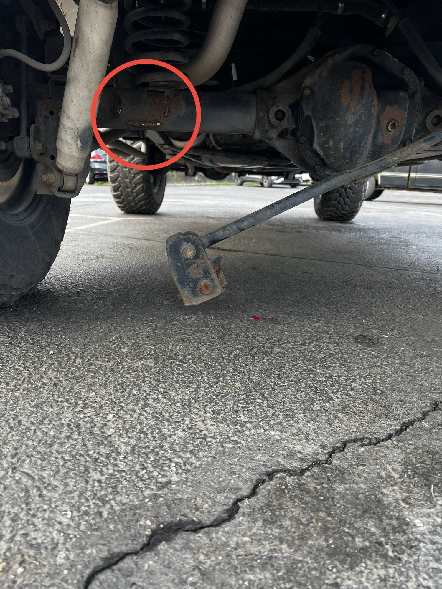

Well It's been a year of collecting parts and my Jeep decided it was time to have me put them on. As I drove to work last month, its back end was all over the place. I pulled over to find the track bar dangling like a dingleberry. Who ever put this cheap bracket on did a terrible job welding it and it just popped off. I got the jeep home and put the back end on jack stands and started to re-do the backend. I had been putting it off because I have another project in my shop and didn't want to work in the mud in the rain... well, that didn't work out for me.

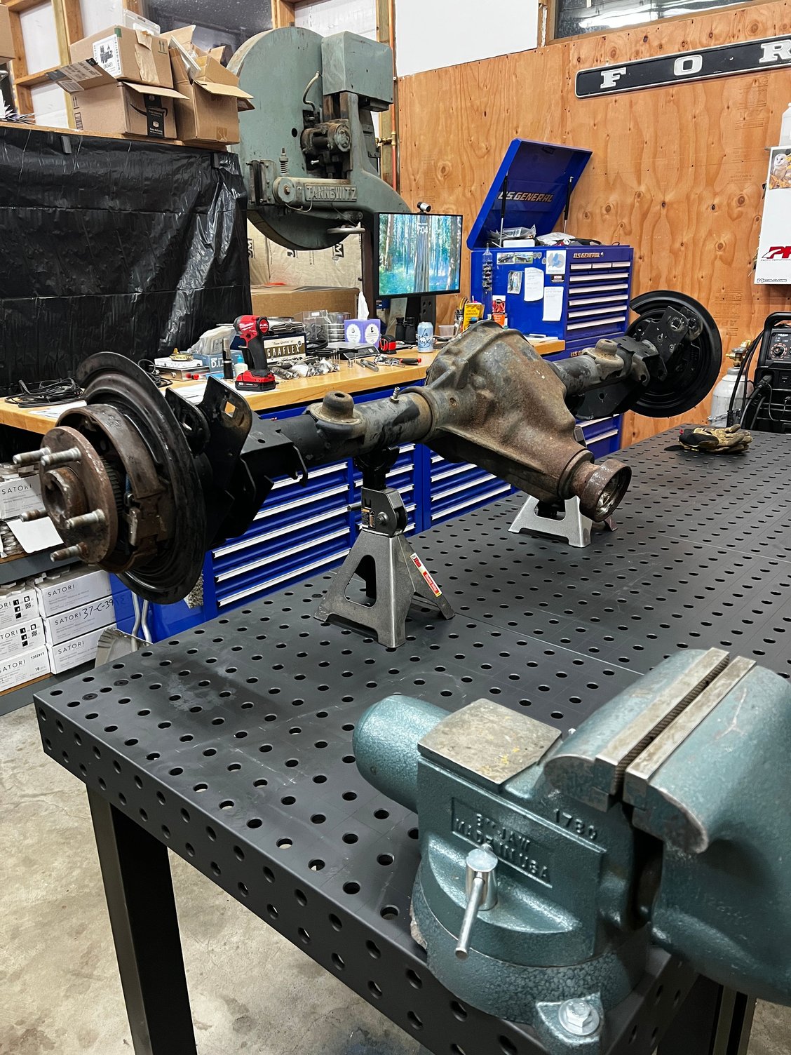

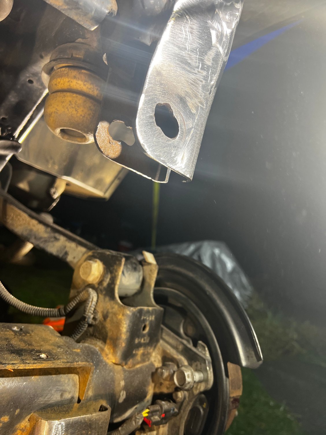

I discovered the frame mount track bar bracket bolt hole was hammered and stretched into oblivion so I needed to repair that, too. I also have a pair of Falcon shocks to install along with weld-on skid plats for the lower shock mount. At first I tried to do the work with the axle still on the jeep for some unknown reason. (it's my only vehicle so I was stressed to get it running). but after incredible difficulty laying on my side on the ground welding I came to the brilliant idea of removing the axle and putting it on my bench. Should have done that from the beginning.

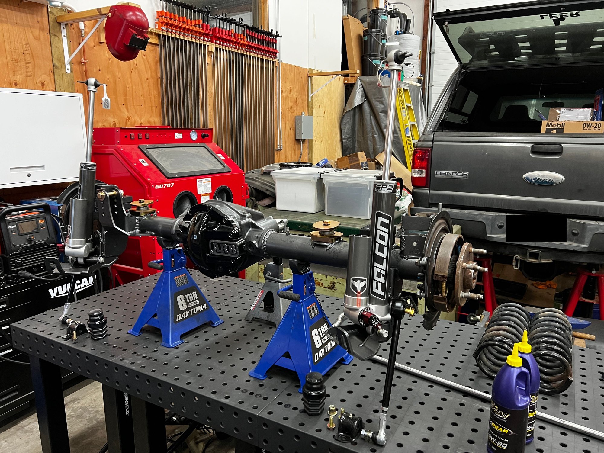

Anyhow, I thought why not add some pics to show the before and after. I can't afford a $7k axle so to me it was worth the work and investment into this axle. Next year I plan to re-gear it w/ lockers and new axles at which point I'll decide if I want to sleeve the tubes.
I stripped the axle, drained the diff, checked the gears, and inspected everything else. This is the list of things I did: (pics to follow)
1) shock mount skid plates (Falcon)
2) axle mount track bar bracket (Artec)

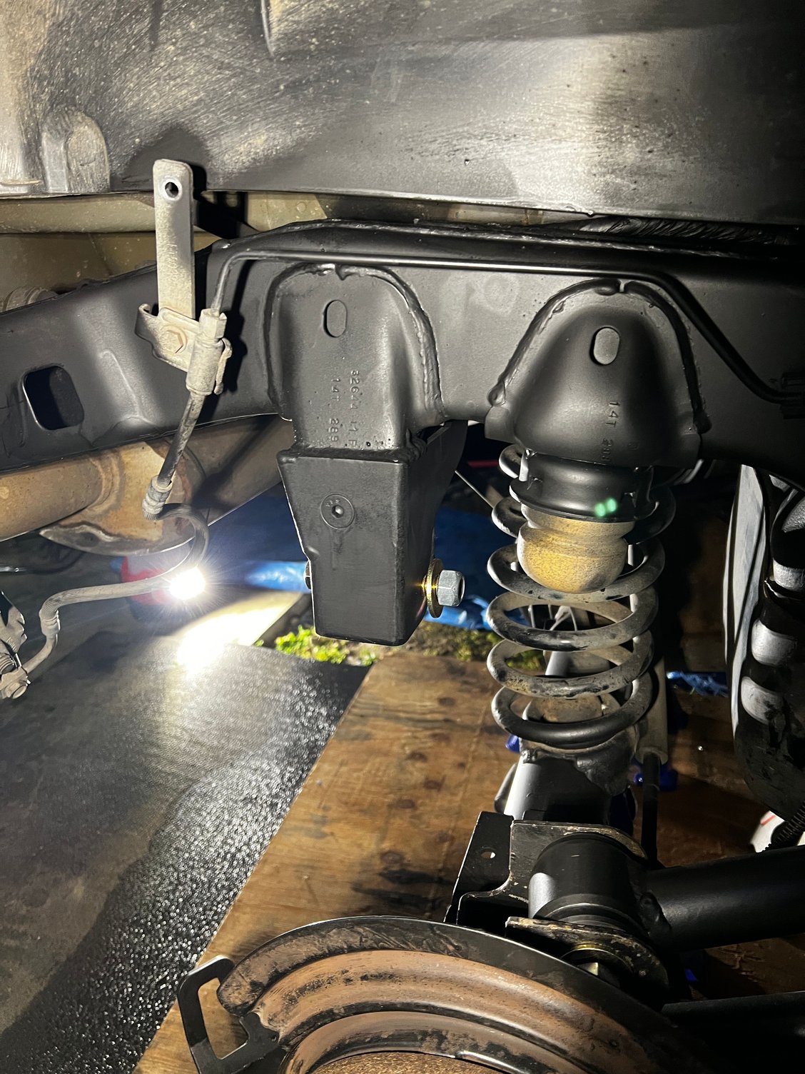

3) frame mount track bar bracket (Synergy)

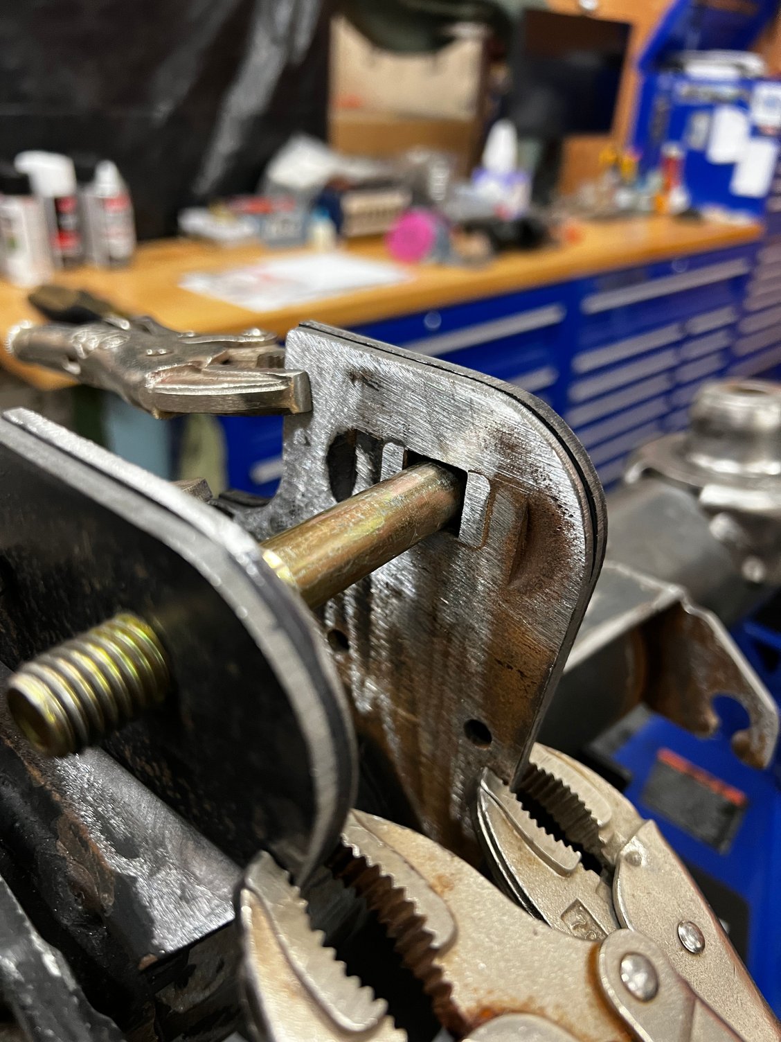

4) re-shape control arm brackets and reinforce (the upper ones have square holes and the bolt bounces around in it) so I added 3/16 steel plate to all brackets after reforming them to fit new control arms. also drilled 9/16 holes to fit bolts well.
5) welded tubes to diff housing
6) replaced the pinion seal and installed the yoke for my new Adams driveshaft
7) did the same to the transfer case.
8) replaced the diff cover (ARB cover and lube locker gasket)
9) pulled the sway bar and replaced the bushings with poly and added a grease zero so I can keep it siliconed. (the sway bar had been worn in the bushings and I can't afford to replace the it with an anti-rock bar). (energy Suspension)
10) I probably made a mistake with the sway bar by stripping the eurathane coating off and repainting it. I expect the paint to come off in short time, but maybe by then I can afford a new sway bar.
11) installed new, longer links (Synergy)
12) replaced upper bump stop and lower pad (metal cloak)
13) New bolts all the way around.
14) Control arms and Track bar (Core 4x4) - I bought the Camp series but now regret not getting the crawl series which have Johnny Joints on both ends. The poly bushings are not bad but JJ's would have been worth the extra $350. live and learn

i have had a rear TB bracket sever from the axle tube like that as well when driving. no fun! thank goodness that back then I still had factory control arms which didn't allow the axle to shift too much as I limped to safety, but addressing something like that in the middle of colorado while on a trip was a pain!! axle looks good. nothing wrong with that D44, outside of being semi-float, but that is what it is.
