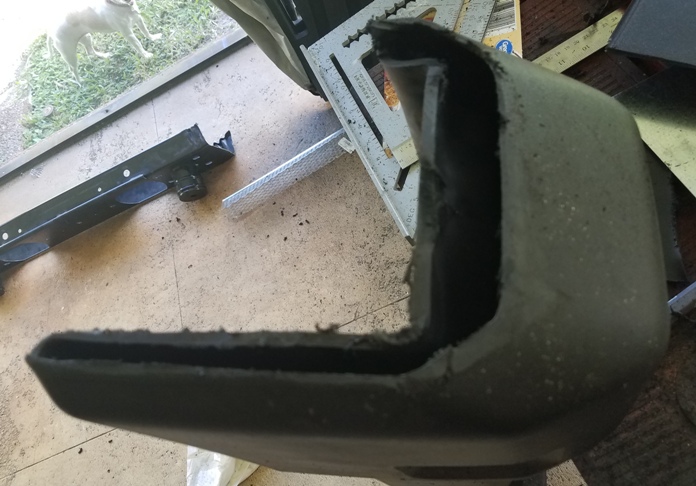

Removed the metal sub-frame and cut plastic up to the outcrops. The sub-frame, I cut to just a half inch shorter than the plastic.
The end of the bumper before creating the end caps. I used my grinder with a cutting disk instead of my sawsall. I find that grinder gives me a smoother cut.

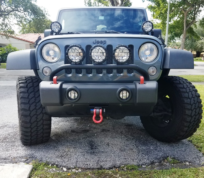

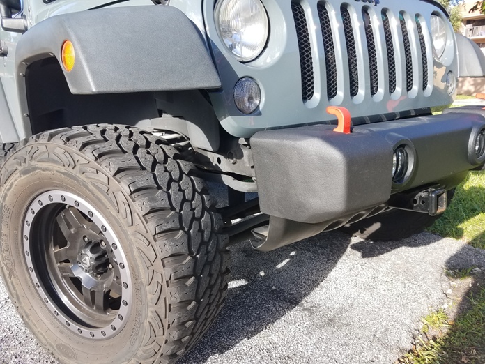

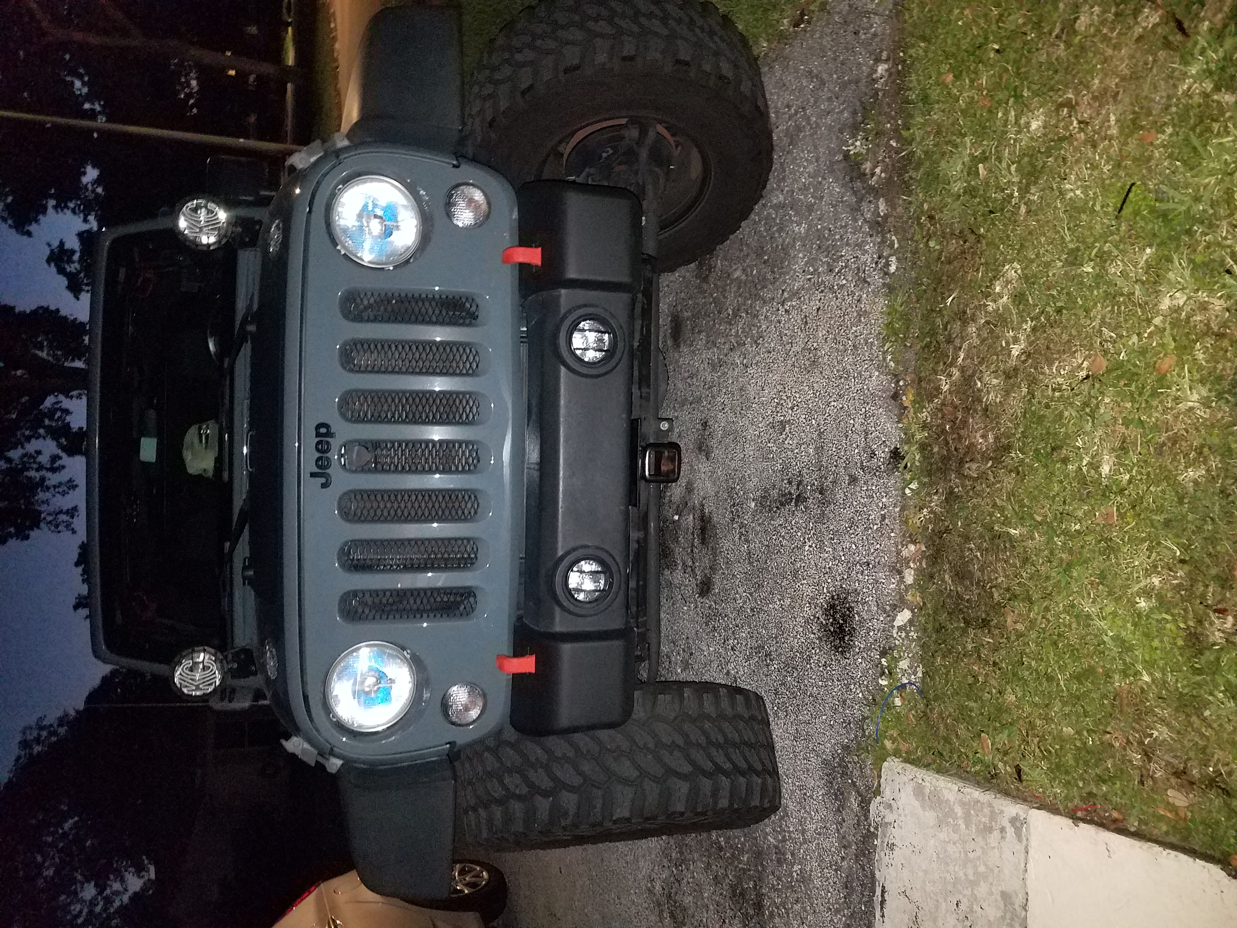

Bumper in place. I have another project after looking at this picture. The brush guard, when cut, gives the impression of being flimsie and weak. I will be welding a piece there to give the impression of it being heavy.
Finish product. I have a front end hitch that I painted along with the OEM hooks with HVT porcelain paint. I baked them in a large toaster oven I have for just such occasions.
