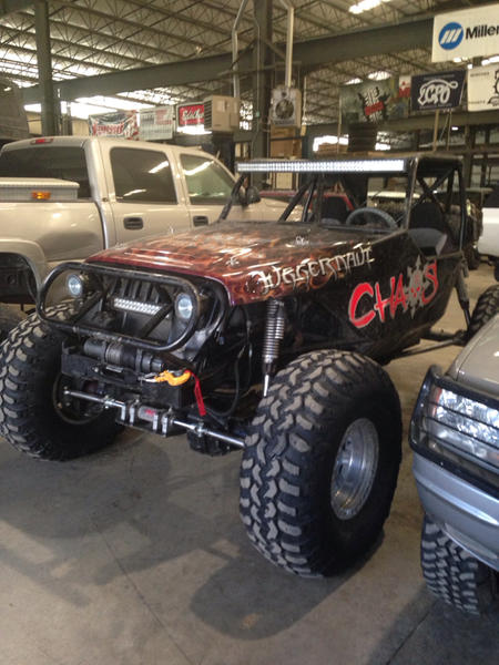

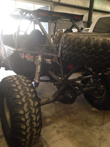

Well the jeep is at the shop... Went ahead and put some Teraflex BJs I because the stickers were pretty much done. Also I was sent two rear D44 master install kits so luckily, Chaos had a Yukon install kit (Overland Off Road ordered correctly but whoever shipped their parts out to me dropped the ball, shit happens). Chaos is awesome northern Va Folks. Fab work is the prettiest I've ever seen, It's almost art! And they've been breaking and building this "TJ" for 15 years now... If you can even call it a TJ anymore? Lol

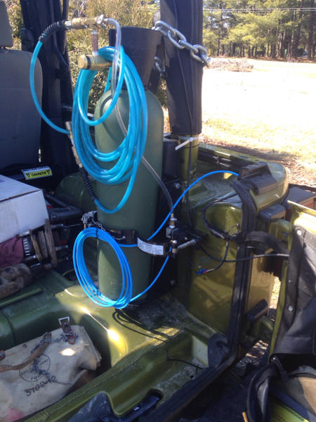

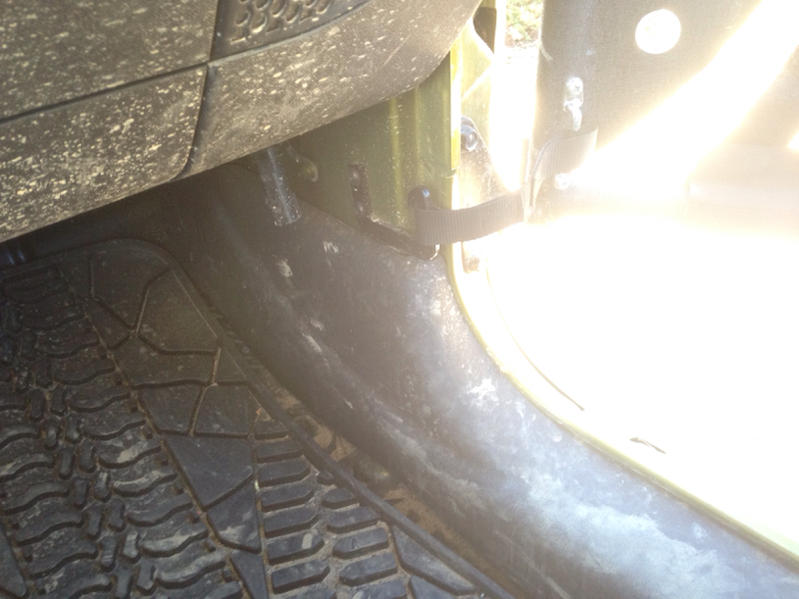

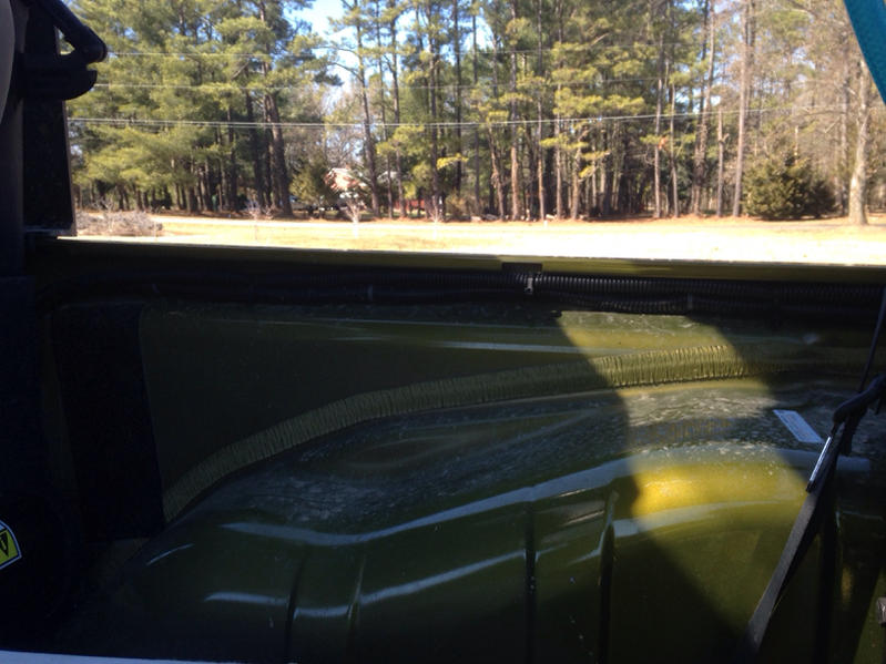

Got my ARB rear locker completely wired up this afternoon after goofing around with my buddy's drag link this morning for 3-4 hours. Hooking it up actually isn't too difficult, the hardest part is finding the right brass fittings to make it work. I put a "T" in mine so I could use the locker or air up without switching hoses and such. I also decided to not be lazy and run my electrical the best I could. Up until the last 6" you would never know it wasn't factory and everything is hidden under the trimming from the seats forward.
