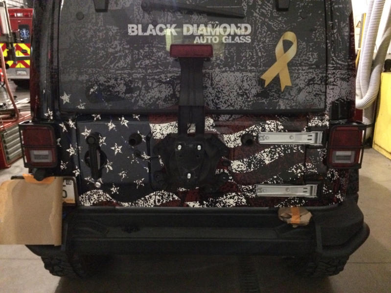

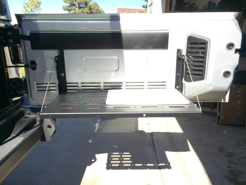

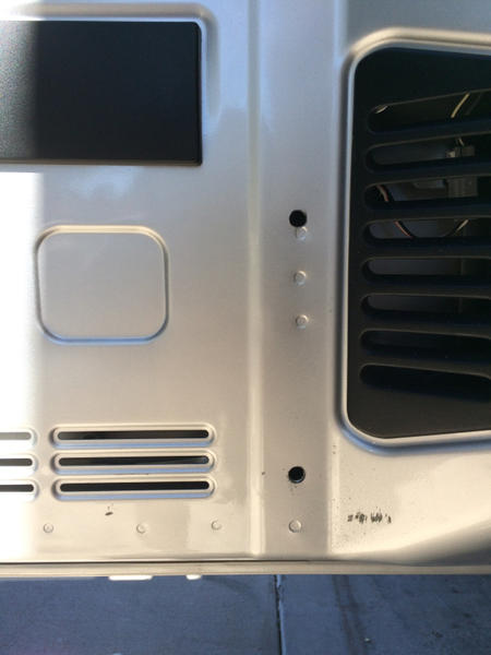

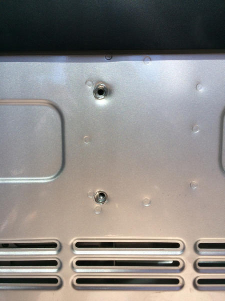

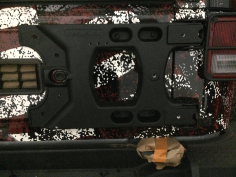

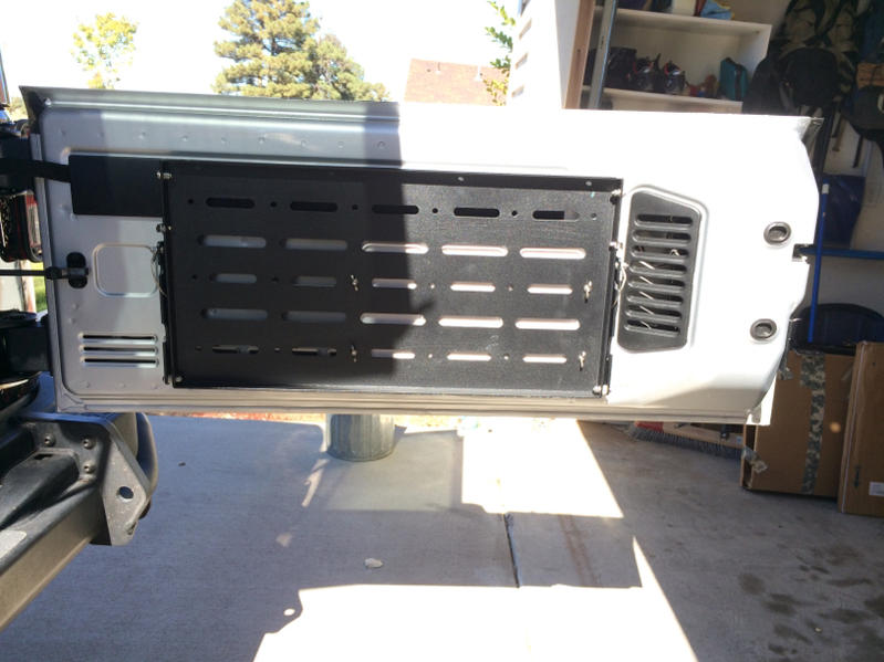

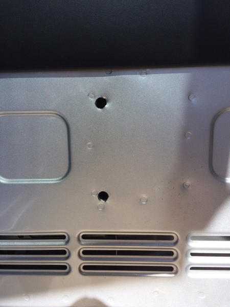

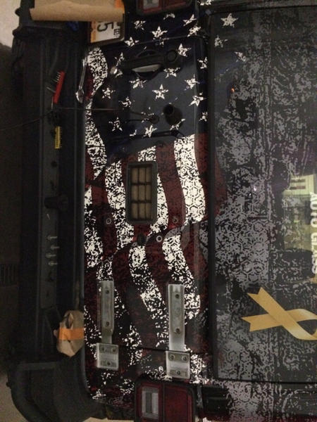

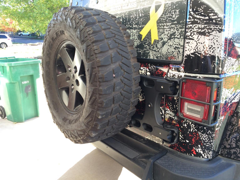

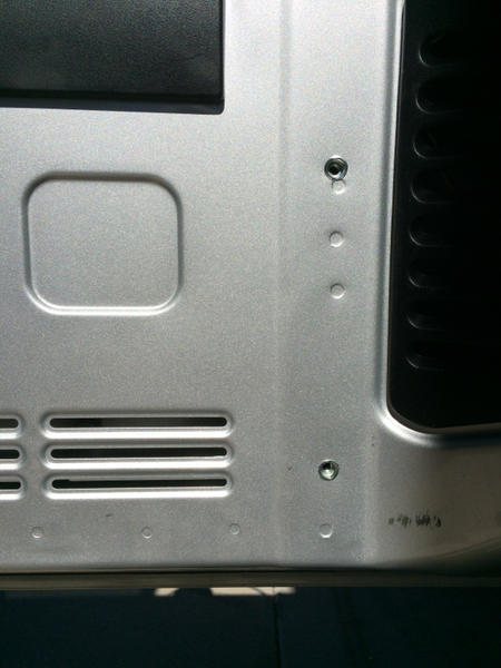

Over the last couple days I installed the Teraflex tire carrier and tailgate table. Both were pretty simple installs and the videos made it quite nice. I did learn a few pearls, in regards to the tire carrier, remember to unhook the third brake light cable prior to removing the carrier. This is done easily by removing a few T20 screws from the back side then un-clipping the brake light connection. The directions also state to open the hinge a few degrees on the carrier, let me tell you this was no easy feat as the hinge is very tight! I had to use a cheater bar. In regards to the actual tire carrier I found it a little challenging setting the wheel studs in place. Also if you rely solely on the video, be careful as the diagram is not the same in regard to where to put the studs in the holes. Apparently there may be two versions. The table was quite straight forward. I did miss the mark a bit on on hole but just over drilled the hole on the table to compensate. The table is very sturdy and most importantly, rattle free! Here's a few pics of both installs. Click image for larger version

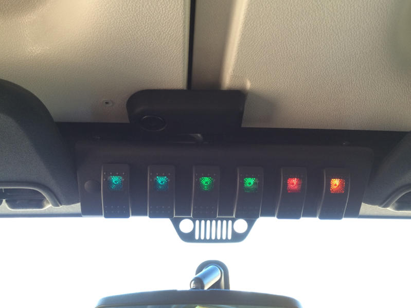

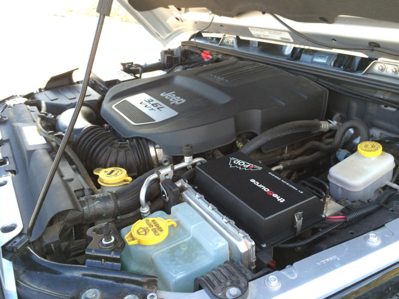

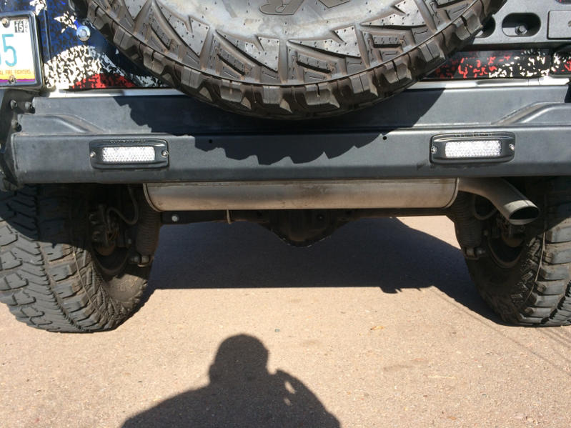

The build is coming along quite nicely. I had a chance to install Rigid Industries SR-Q flush mount back up light kit. I mounted them into my rear AEV bumper. Click image for larger version
ID:	582424 Click image for larger version

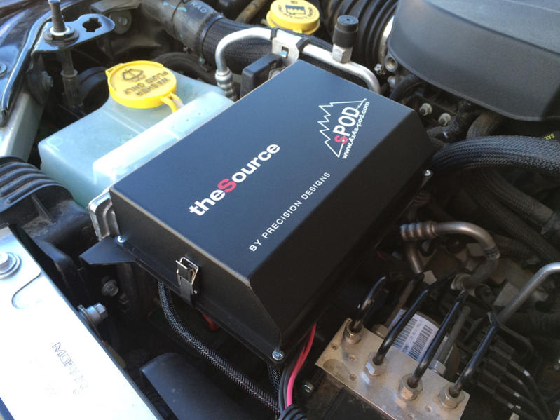

ID:	582425 What better accessory to accompany them than the sPod. The sPod is a terrific product great quality and OEM appearance. Many people have a hard time with the price point but in my opinion it is well worth it. Click image for larger version
ID:	582426 Click image for larger version
On Tuesday the jeep goes under the knife for the TeraFlex pre-runner in stall. I'm excited and nervous at the same time as this is my first major project with the jeep. Nothing like cutting apart and welding on a nearly new Jeep!
