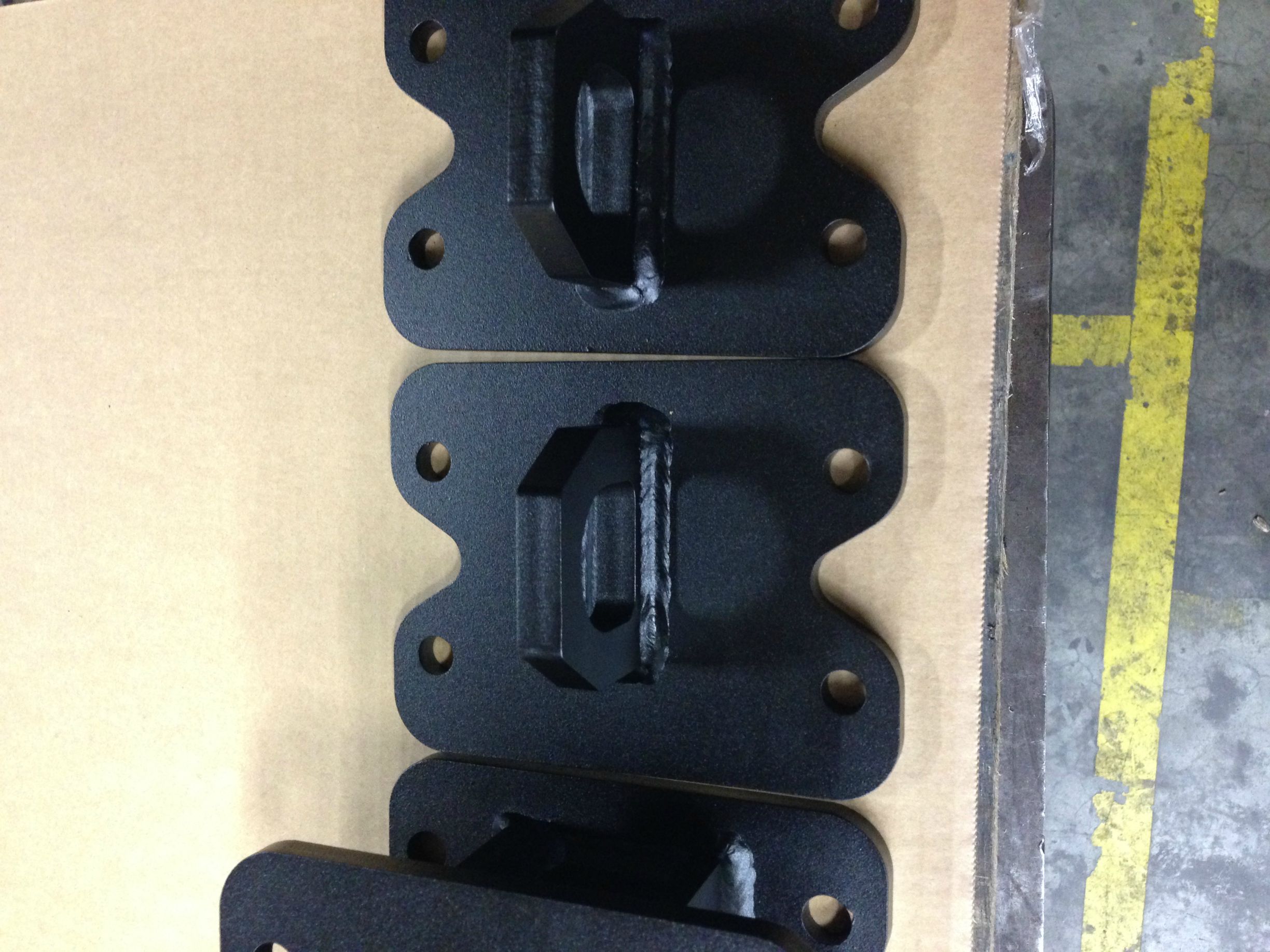

D-ring Mounts 1/2" Ring

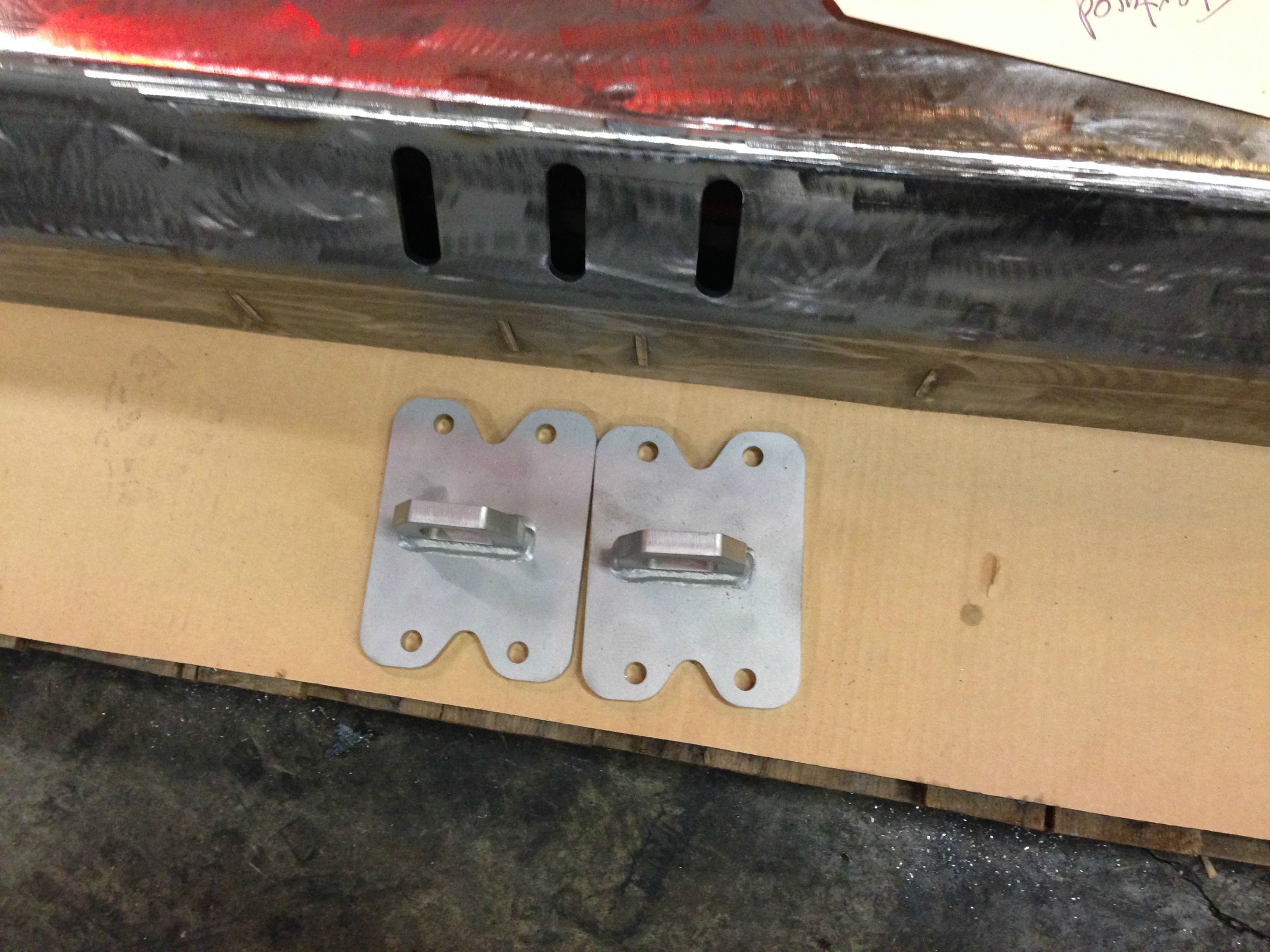

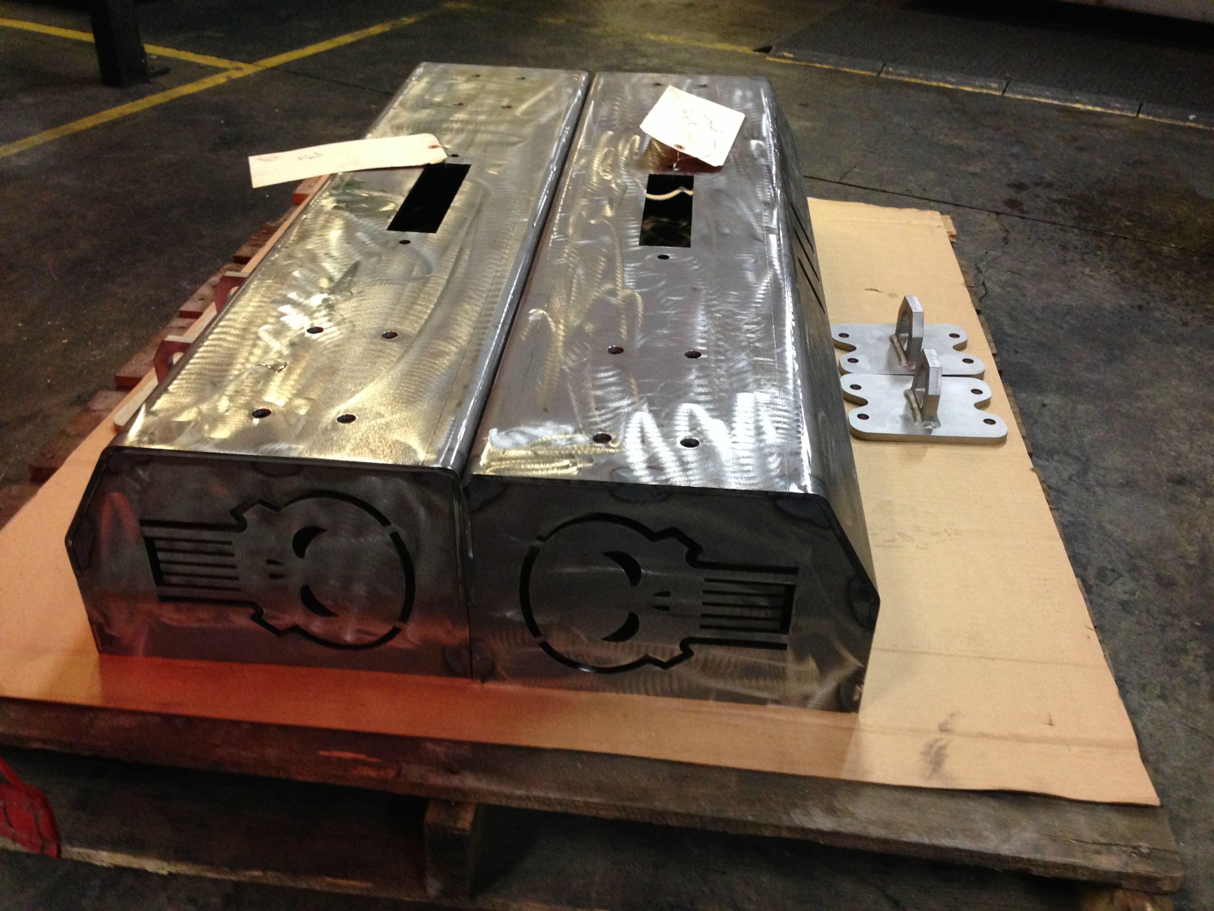

First Pictures after getting cut bent and cleaned up

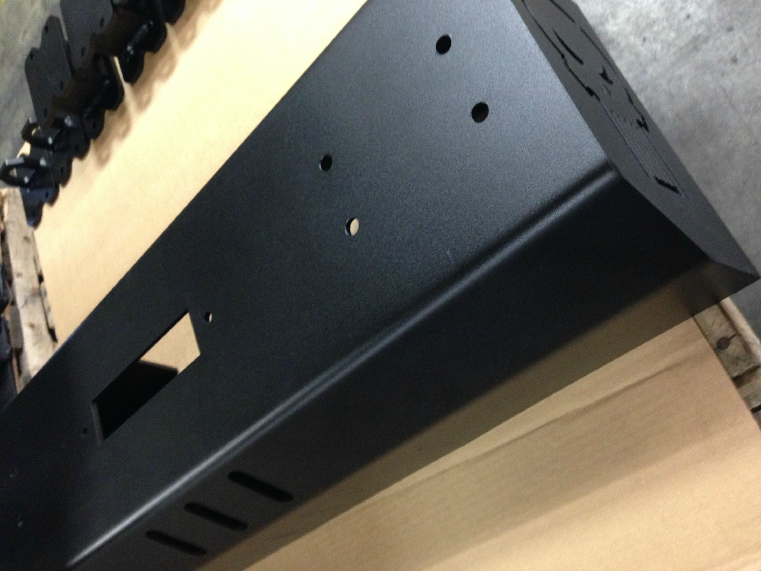

Fresh out of paint

Old Dec 3, 2014 | 06:11 PM
Captain Obvious's Avatar
Joined: Oct 2012
Posts: 346
From: Houston, TX
Seriously impressive craftsmanship! The fit and finish is on par with professional work, not back yard fab.
I would recommend redesigning your shackle tabs so that they're a tighter fit in the hole. A hole that size could allow shackles to bounce around during recovery and shock loading could lead to failure in a very bad manner.
Again, amazed by the craftsmanship!
