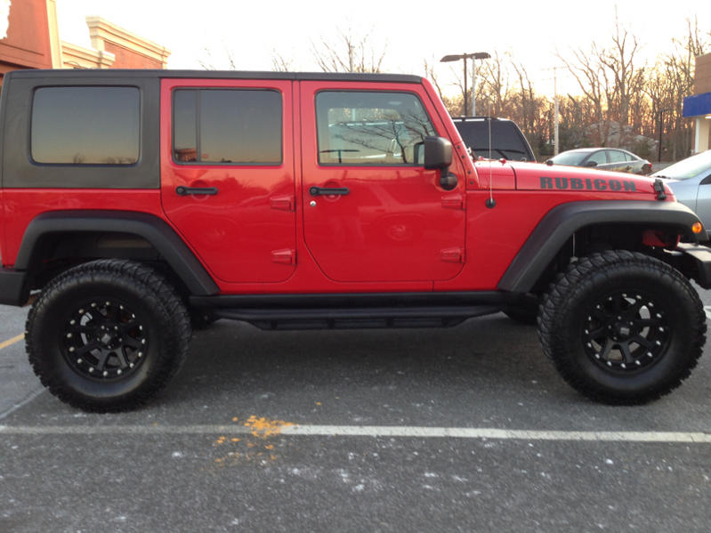

My 2010 4 door rubicon pings when I use the recommended octane fuel. When I switch to high test it goes away. Is this a engine problem?
