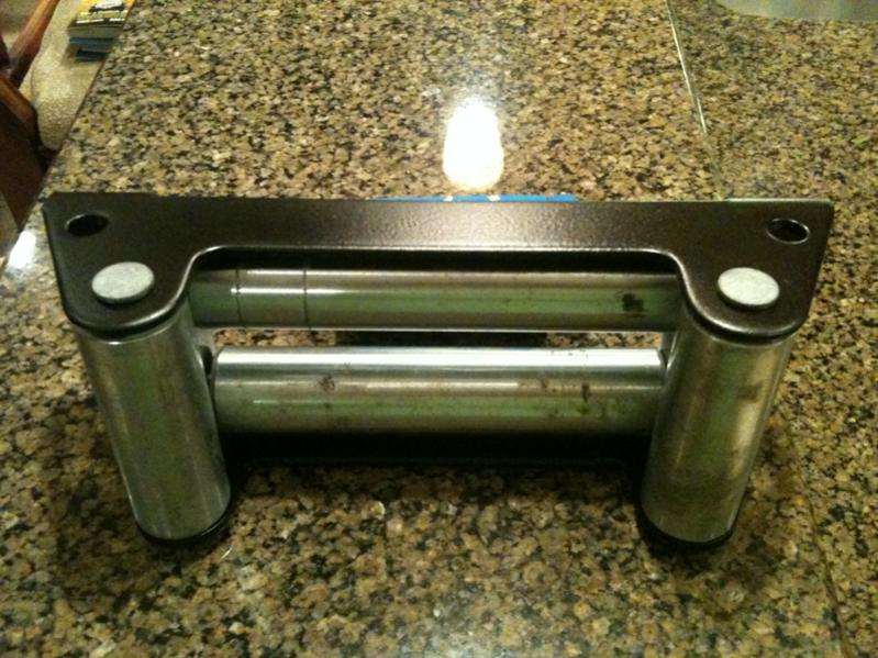

After seeing how hard it is to come by a steel hawse I might end up with a roller and plate cover.
Post your steel hawse fairleads if you have them. I only see warn's and that bad ass one from Evo looks steel...

Best I could come up with. Painted it black.
