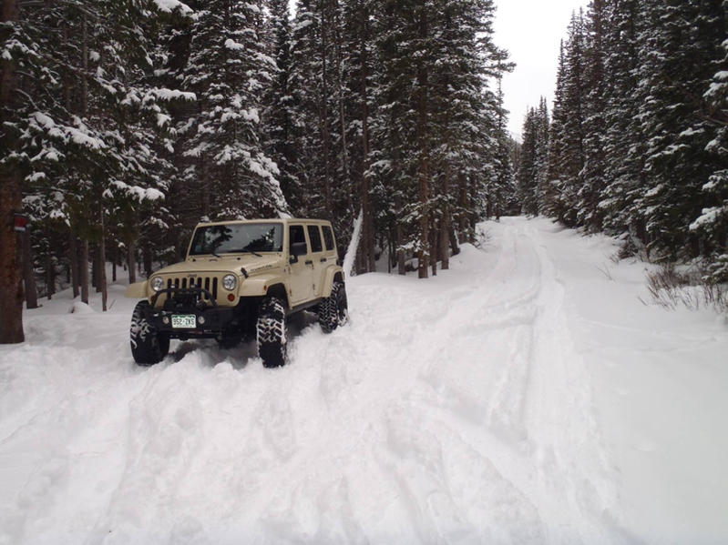

I had mine locked in for about 4 miles on this road today. All soft, deep, powdery snow. Got to a point that it was nearly 2' deep. Even lockers in 4L wouldn't cut it. Need chains, or better yet, tracks for that stuff. But I agree with the others. Only use them as needed.

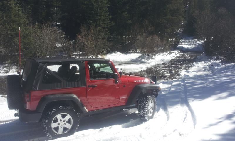

The snow was fun!

where did you go today?
