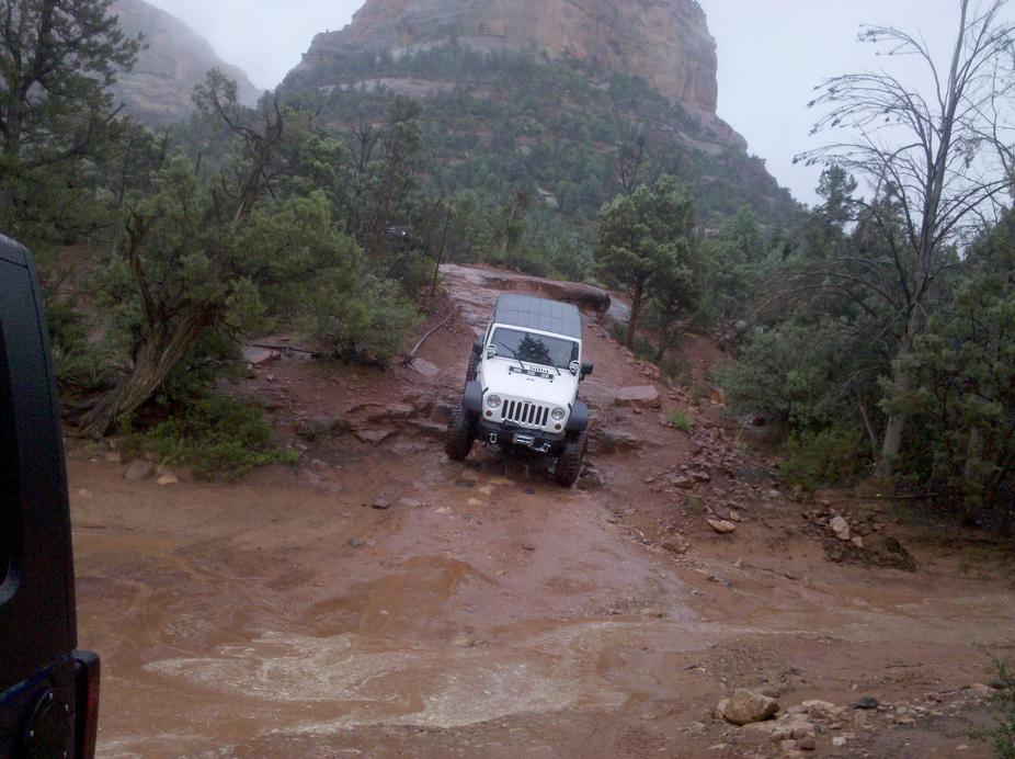

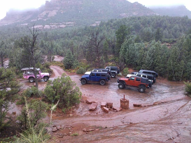

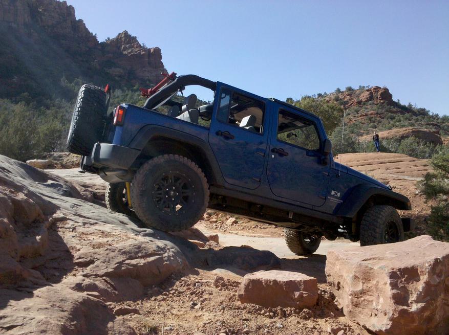

With an auto just run all broken arrow in 4L. The trail is pretty short, but a lot of great views. The 2nd half has all the fun stuff on it, but it is not too serious. The pink jeeps are all over that trail so 4L keeps you moving no faster than you ever need to on the trail. Following the pink jeeps you can even stay in 1st on 4L.
Here are some pics from that trail (it was raining our last trip)
