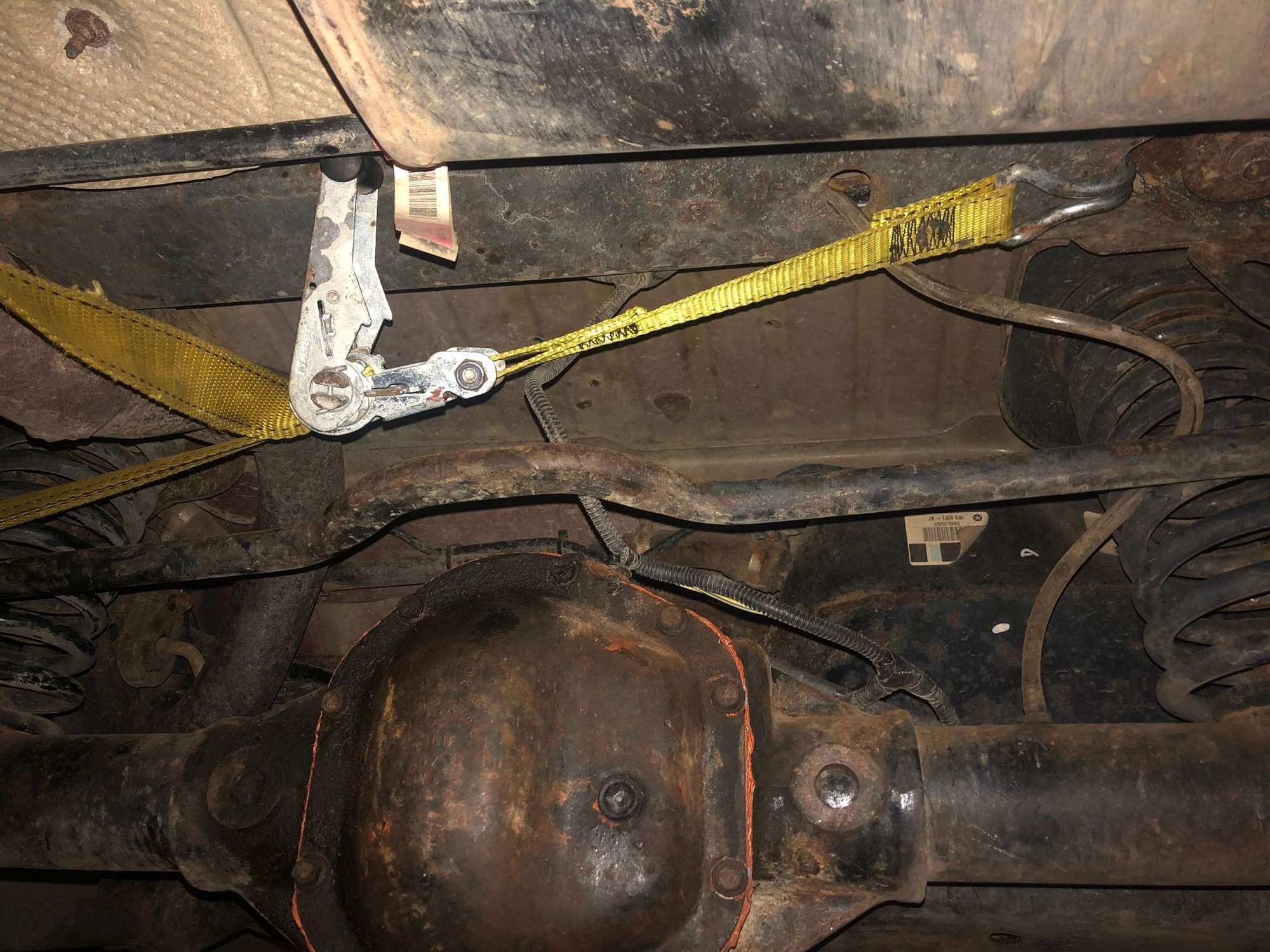

Broke the rear track bar mount on a 2007 JK Rubi. Ratchet strap from frame to axel limped it home 80km forestry roads, highway (hazards at 60kmh). Axle was lined up entire route. Lowers drivers mirror to keep an eye on the axle. In extreme off road conditions this may not work...just saying

hella long ways to drive like that I had a rear TB mount break on me before and know it's no fun at all.
10kms an hour on the forestry road. No cell service. My sidekick watching side mirror for axle movement the entire way. It held up solid. 😳
