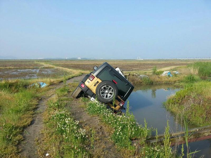

Hey all. Got myself into some trouble the other night in a rain storm that created some seriously thick mud. After getting it stuck in a ditch with my passenger side wheels up above the rims in the muck I had to leave it for the night. The Jeep was at about a 45 degree angle like this... For a few days I had no issues now I've noticed a squak coming from the passenger side. It happens pretty consistently under about 30mph and seems to go away. It also comes and goes under braking as well. Any suggestions? ?

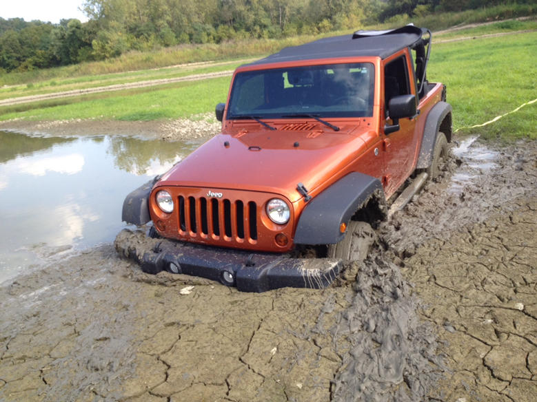

Like the first reply, clean out the brakes and the dust guard. Had the same problem from getting stuck like this. Sounds like death, but it'll be fine once you clean it out.
