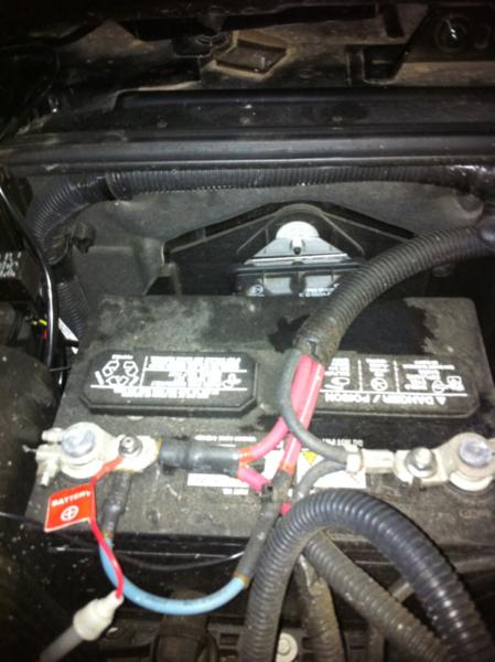

Does anyone have any pics of the installation of the wireless control system? The directions say to mount it under the hood in a dry, flat place. I'm sure when I look under there I could find a place but I'd love some insight on it. Post any pics you guys have please!

I'm running 2 sets, one Driver set mounted on the Windshield, the second are a set of Fog's mounted on top of the Fairlead with the Poison Spider adapter. As far as the wiring....both boxes are mounted atop of each other (Velcro) between the Battery and the Fuse Box. I cut all the wires to the needed length and routed them in Plastic sheathing. I also used Velcro to hang the Relays to the Firewall behind the Battery. Very clean install. The Velcro was the Commercial 3M Brand, very strong.

Installed my 6.5 inch last month love them . I installed the box and fuse beside the battery . I used the battery box bolt on the fire wall for the big box just tighten the bolt two turns , put box on , put on another bolt and good to go . ( tight fit but it will go in ) the smaller box ( fuse ) I mounted to the fender beside battery there was a hole there so I just put a self taping screw . Will put bolt latter . Then I ran the wire to the front passenger side light under the fender and tied in there . ( again tight fit but great spot . Will post pics when I can

Pics of install srry from phone don't know how good they are hope it helps
