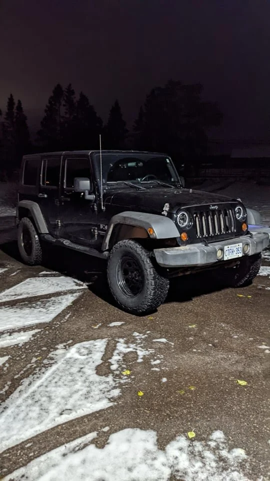

Here is my Jeep that I picked up a few months back.
From the sale ad
First night home
My Sons first "look"
So when I bought it, it came with 18" Jeep wheels with barely passible tires and 17x9 8 hole Steelies with 35s that were closer to a racing slick. After a conversation with my local tire shops on what was available, I went with 34" (285/75/17) BFG KO2s on the Steels. I believe I have about a 2.5" lift that has SkyJacker shocks. I dont have any info on the springs at this point. I also replaced the headlights with LED Halos and have the matching fogs that will go in when its warmer. I have also installed a pypes high clearance exhaust that I found for cheap locally
Inside I upgraded to a factory myGig 730RER and added all the antennas needed to make it fully functional. I also installed some Grab Bars that I was also able to pick up locally from Facebook Marketplace
the Front driveshaft was clicking, so I replaced it with an Adams 1310 as well as ordered a full size KO2 spare and 17x9 wheel. Lastly I switched to an LED ring for my third brake light and got new black center caps.
Im sure there will be more to come
