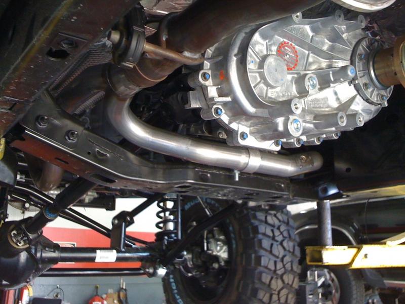

I've been running the aFe y-pipe for about a month and I've had no problems with it. I'm looking at their hi-tuck cat back exhaust and maybe their CAI. Here are a couple of shots after the y-pipe was installed while my Jeep was on the rack.
Attachment 235044
Attachment 235043
What is your review of the sound difference and power difference?
