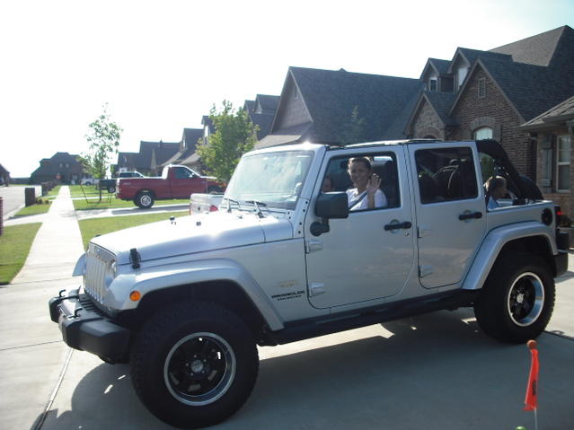

Hello everyone,
My wife currently drives a 2007 Sahara 2wd 4 door. I am wondering how difficult (and expensive) it would be to convert it to a 4wd. I found a webpage that explains how to do it (http://www.4wdandsportutility.com/te...ion/index.html) but I am wondering if it is worth doing. My thoughts are I can build my 4wd with any components I choose instead of settling for the stock ones if I was to trade it in for a new one.
What do you think?
