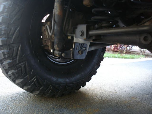

Got my 35" Wrangler MT/R Kevlar installed finally on 15x8 Cragar V5 with 3.75" backspacing. STILL had to grind down the forward lip of the caliper "bracket" to clear.

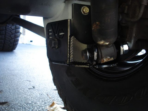

He also welded in my EVO C-Gussets and I installed the EVO RockStars a few days ago. He ramped the JK with the lift and had 0 problems. I hammered in the pinch seam and clears NICELY. Shocks are not bottoming out NOR fully extended, have about 1/2" left in travel, with OEM shocks.

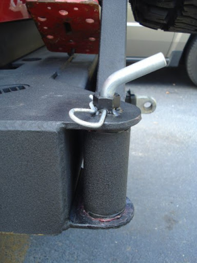

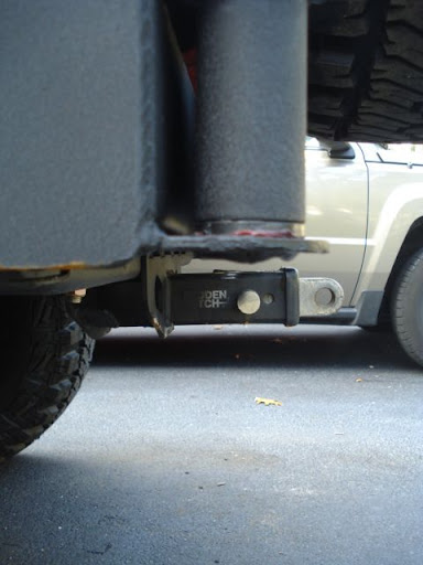

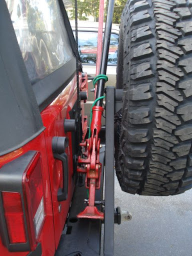

Last week he modified my Rancho carrier. They use hitch pin as a handle and everytime I decended an obstacle last month the pin hit the boulder and flew off, 6 TIMES! So, he used a cotter pin style nut, welded it upside down, and drilled a hole through the hitch pin. Now, nothing to fall off, and it's actually tighter than it was before.

Question did you remove your ball joints before you welded on the C gussets?

Originally Posted by Wings fan
Looks great!
No. He welded a stitch at a time while keeping a damp rag on the ball joints. Ball joint never got super hot (you can actually touch the ball joint enough to not melt your hand). When your torching steel, all the heat gets drawn to the coldest point, hence, the wet rag.
