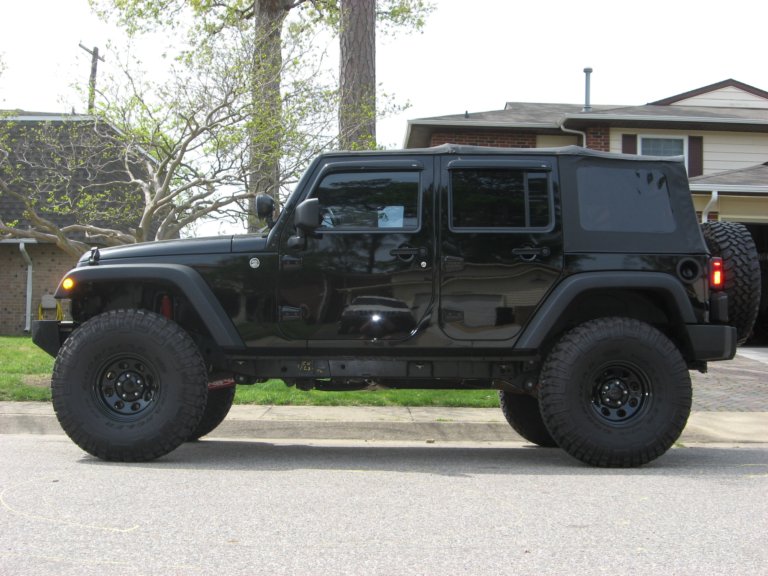

yep running 37s on a 15in wheel, on 4.5 lift, little rubbing issues on the fender and full flex, added extended bump stops solved, but plan to run tube fenders, in future to remove bump stops...oh yea the soft 8 wheels i have the only issue is the caliper face rubs back of the wheel, a 1/4in spacer fixed theat, if you go wit a rock krawler street lock or the D whole steel wheels, they dont rub, because of the taper of the mounting flang to the rim...rim size for that tire 15x10, with 3.5 to 4 back spacing would work,
