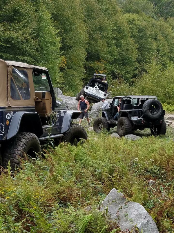

You definitely have some trimming to do. Personally I think a nice beefy 35 is better suited on a 2dr. And more stable as well.
That is definitely a personal opinion.
I'm running 37s on a 3.5" metalcloak lift and I couldn't be happier. Stepped up to that from 35s and a 2.5" lift. I don't think 35s are better suited for a 2 door at all. In fact, it's entirely up to what the OP is willing to invest and what the intended use is for the Jeep.
To the OP, if you want to do that, go for it. But if you do it, do it right and know how to properly setup your steering. Use adjustable control arms to get your driveline angles as best as they can be. And yes, be aware that you'll need to do some trimming for the 37s. You most likely will also want to regear and beef up axle components for the wear and tear that the heavier tire will put on the axles.
