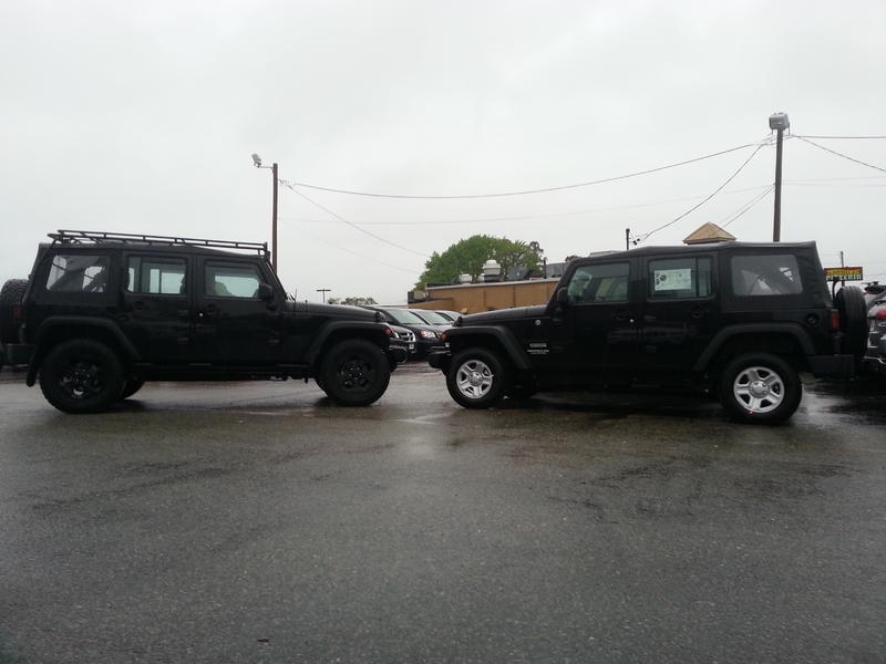

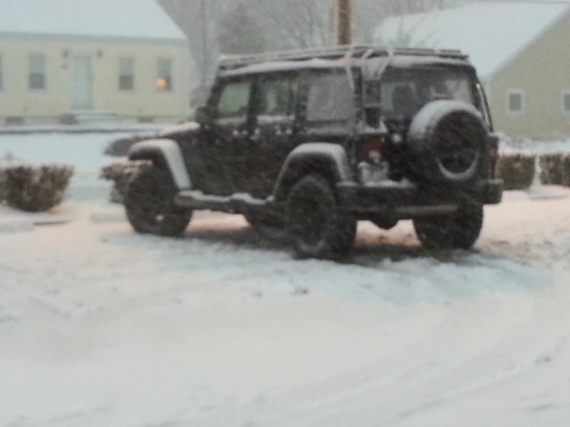

Looking for pictures to help determine if it sits truely level... Read on aev forum that it doesn't change the factory rake.
ID:	509628Click image for larger version
mine on the left.
sorry for the bad pics

Yes it removes the rake.

I would bet money that it doesn't remove the rake on a Jeep, you're adding 2" to the front AND rear. It's simple math. If you go with the TeraFlex Leveling kit (2" front 1" rear) then it would remove the rake from a Jeep.
You owe me money!! The AEV 2" Spacer Kit's spacers are not 2" Front and 2" back. The rear spacers are thinner and you also remove the rear factory spring isolator, but keep the front isolator. Result = Leveled

That picture of the 10A Jeep is mine with an 75lb ZEON 10S installed in the front bumper.
Ahh I was not aware the rear spacers were thinner, interesting. I'll buy you a beer next time you're in Pittsburgh!

LOL, no problem. The info about the kit doesn't really explain it. If I didn't have the kit I would of thought the same too.
