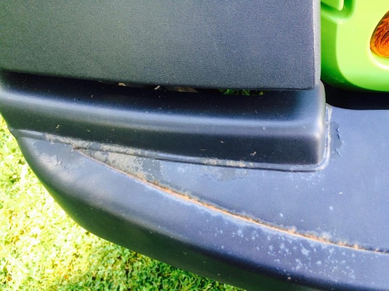

2yrs old. Front bumper. Anybody else have this issue?

Have you been to the AEV forums? They have a thread addressing this issue. The new AEV bumpers have drain holes where the seam/rust is in your pic. I would try to emulate that drain hole and touch up your bumper with their paint.
